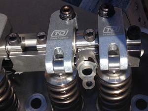

I choose the T&D Sport Comp part # TD10001-60-60
The 10001 has a .220 off set on the intake and .080 on the exhaust.
A 3/8 push rod will clear with ease.
A plus for the T&D over Jesel is the stands will allow you to run any head bolt
or stud you want. The Jesel rockers comes with a special head bolts to clear there stands. I hope this info helps someone with there build.
