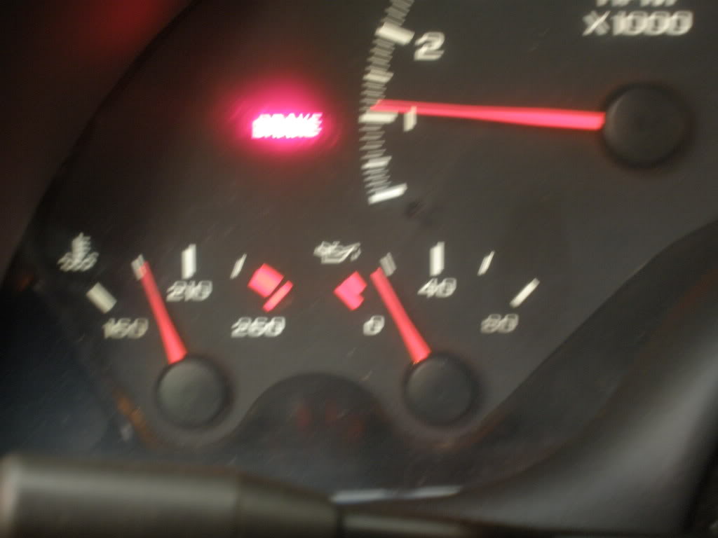

this is the lowest i could get the oil pressure to go i had the car all the way warmed up then turned the fan on high to bring the temp back to 180 and it went to about 15 but i didn't drive the car just let it idle in the garage.
ignore the rpm gauge saying 1100 it is off by 200 rpms i have verified this with a scan tool.

That looks ok. what kind of oil are you using. I would use 10w30.

that is what the pressure usually is but when i drove it around the block on fri and came back it was down around 10 or 5 when idling smoothly at 900 or (1100 acording to my tach)

that pressure is fine. and the not idleing after a pull is a tuning issue.
