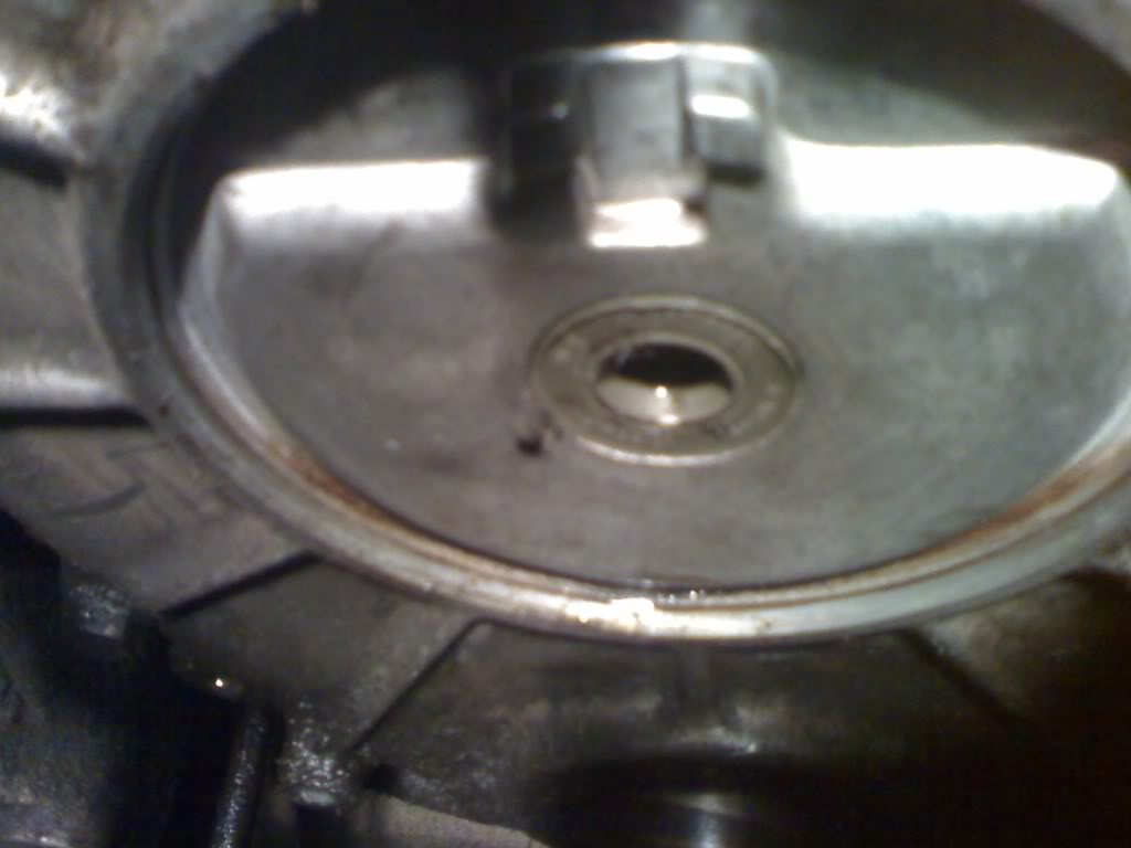

Hello everyone i have an oil leak coming from the front of my engine. its not the waterpump seal and I dont think its the opti seal. I dont think its the optiseal because my optispark was dry except where it mounts at the bottom it had a small line of oil? is that normal? Im leaking way more oil than that. So the next possible places it could be leaking are from the crank seal and the timing cover seal? I also read that the front of the oil pan gasket can leak also? Are these the only front seals left that leak oil? Does anyone have any write ups on how to remove the crank hub and i have to drop the oil pan anyways to take off the timing chain cover right?? Any help is appreciated! thanks..
Heres a picture of that small line of oil at the bottom where the opti mounts.

Most likely your crank seal (if you are sure it's nothing else) as the crank can sling oil everywhere down there when it leaks. If you are going to replace it might as well take the whole timing cover off and replace everything (WP seal, opti seal, crank and TC seal) while you are down there. Did all mine just a few months ago.

Yup, same with me, crank seals blow out on these all the time, I was quoted $1800 to replace it so I just did everything while I was at it like DAVE00 said...could it also be the timing chain cover?
