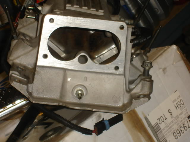

I have an AI ported manifold but no before dyno with this combo. However, factory intake flows pretty darn well so I really did not expect much of a gain over stock at my build level.
however, it sure looked pretty and this combo has great street manners

IMO talk with your porter and ask him....In my case I was told the stock intake would suffice for my goals but their street strip porting would be worth some power.
However, I'm good to go if I ever want MORE power and build a hairier low end or bigger cam.
If you really want a comparison send me a stock intake/throttle body and a couple of hundred bucks for the dyno time and I'll eat the labor and gaskets for back to back swaps.
However, I believe the only results that matter are what happens on your car.

is your mani ported for a monoblade tb?

Yes,

damn an that hump with the hole doesnt hit the tb blade when it opens?

The top of the blade moves inward when the throttle opens....it would have to go past fullope to hit that passageway

Why do you need that "hump" in the intake? Just wondering because I got rid of all the center section when I did my L-98 plenum porting.

That hump feeds each port with air from the IAC motor . There are holes in each runner about 6mm in diameter .

how important is this "hump" as i removed mine too an my car seemed to run a lil rougher since then?
