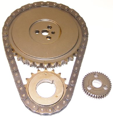

The motor has 64k on it, but the timing chain was changed with the cam at 59k.
This is the timing set I used its a CLY9-3151
