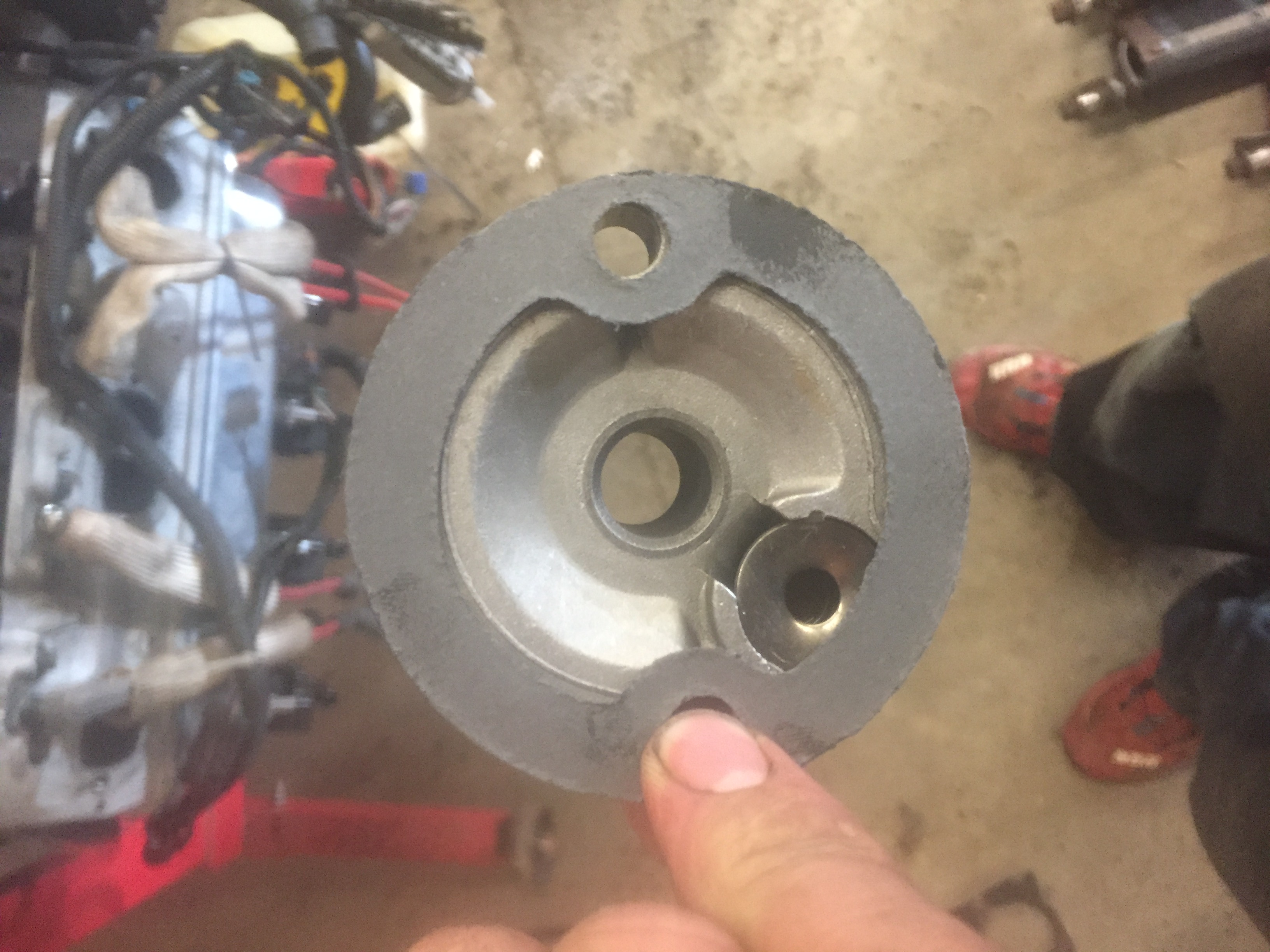

Can you explain this hard gasket that goes between the oil filter adaptor and the block? Or have any pictures.
I am running a PCV valve.
The intake and valve cover are dry. I do have dye in the oil right now and did when the car was leaking really bad. There is oil where the bellhousing and the block meet up.
Re: Oil Leak
FelPro has it in their oil filter adapter seal kit....or the dealer has it
https://www.autozone.com/gaskets/eng...231618_0_12148
It goes between block and oil filter adapter. If it was not put in, would leak pretty bad
If leak is from there I don't see how it would get slung up onto head gasket area
If you look under the car through the small rectangle slit in bellhousing you can see the rear of crank. If oil is dripping from there it is often the RMS. With the dye that would be clear to see...but you would need to pull tranny, clutch & FW to "see" if the RMS was the source or the oil migrated onto the crank from somewhere. Typically from up top like rear intake or valve cover leak but you have checked that.

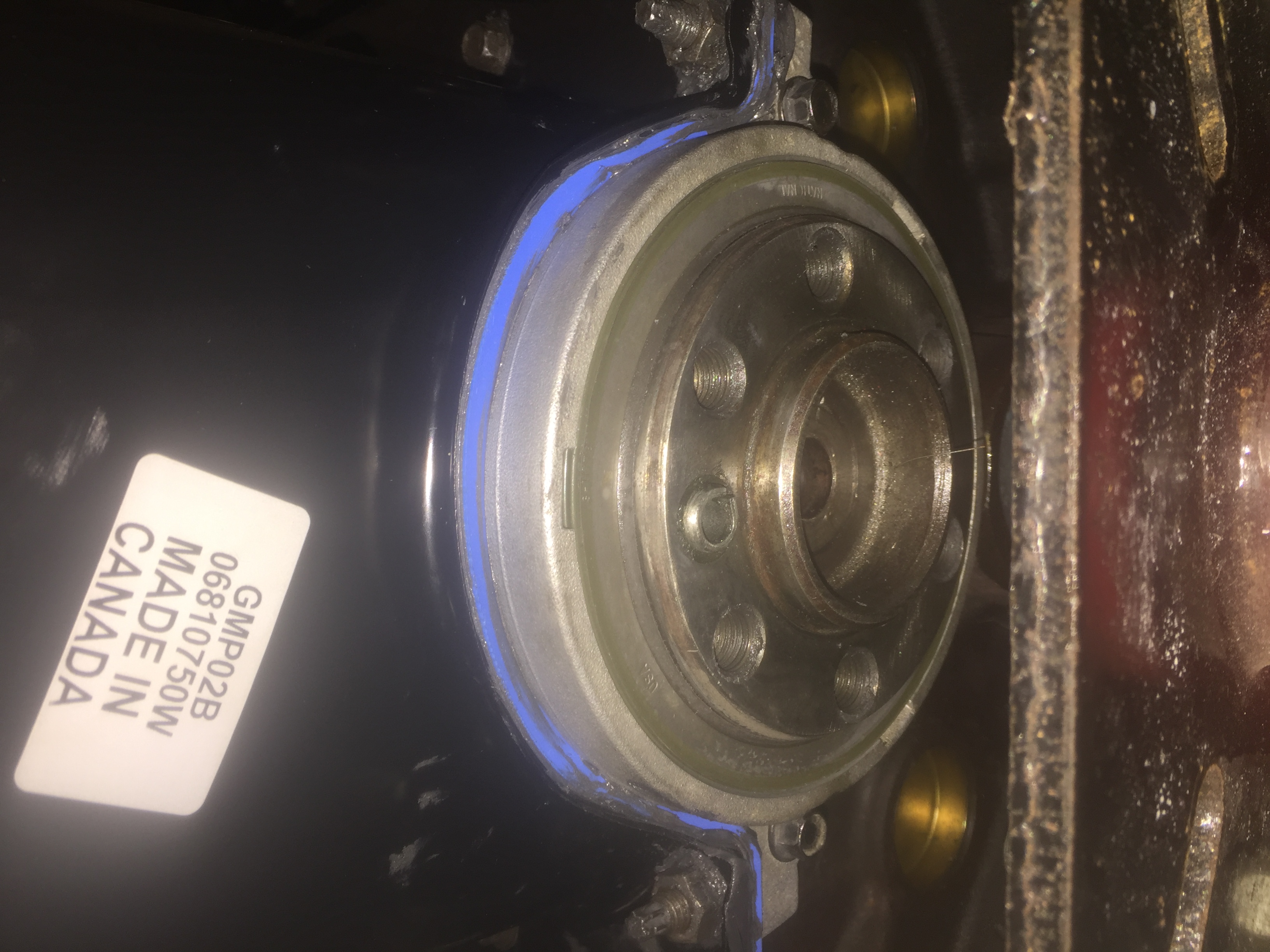

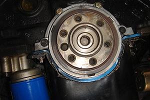

Re: Oil Leak
Yes I am using the stock pan.
I just took the old pan off today and the oil filter adaptor. I cleaned everything up really really good. I used Permatex oil resistant sealant on the oil pan to gasket (entire side). I noticed when text fitting it that the gasket on the RMS side is like 1/2” bigger on each side? Which I found weird. I tested fitted it on my original stock pan and it was the same. Not sure this is normal or not.
I siliconed the RMS side of the gasket to the “arch” over the seal. I did notice the seal was kind of “kinking” on the RMS. I noticed it was like this before with the other oil pan as well! Not sure if this is normal or not! See pictures
There was no seal on the oil filter adaptor. So I put one on it. Not sure how much it’ll help as I assume it’s kind of a sealed system around the oil filter?
