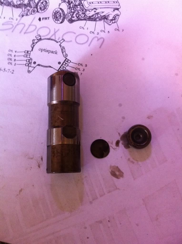

i need a lifter expert to answer this question about the pic below.
there is a small plate just below the the cup on the lifter where the pushrod sits. there is flow out of each lifter at this point but not enough. i place a pushrod on top of the lifter and can sometimes get oil to the top of it, no rockers are hooked up at this point.
if i stick something small enough in the top of the lifter that will push down on the small plate i get a lot of oil coming out of the top of the lifter. how does that plate work and if i hook up all the rockers will it start to move so the oil can come out of the hole? with the pushrod engaged it doesnt allow the plate to move at all so it is the same. with it running would that be a different story?

I installed the rockers just now and set them to a hair past zero lash for now and once its running I'll set to 1/4. I soaked the rods in oil and cleaned the lifters with solvent and I got a little dribble up top now on most all the pushrods. I turned the motor over a few times and I'll prime some more befor I install the intake. Thanks for all the support so far and I'll let you guys know what happens when I get it started tomorrow.
