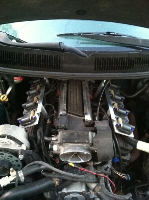

Below are some pics of my LTCC coil setup.
QUESTION: (see pic directly below) From the new LTCC harness, I simply connect the two pink wires to the one pink/black wire on the ICM plug and the white wire to the white wire on the ICM plug correct? It looks like both the pink/black and white wires are on the same plug (ICM plug), and the plugs that plugged into the COIL are no longer used.
Thanks to anyone who confirms that I am correct.
Attachment 6759
Here is my setup: I fabricated my brackets correctly by using another LT1 intake that I have waiting to go on a 383 :)
Attachment 6760
Attachment 6761
Attachment 6762
Attachment 6763
Attachment 6764
Attachment 6765
Attachment 6766

I had to switch coils :mad:
This project has been a pain in my butt, much bigger pain than I had anticipated.
I did not have the harness that plugs into the LS1 coils that are pictured above (GM part # 12558948). The LS1 harness is different than any other harness. I was bummed to discover this when I tried to plug the Vortec harness into my LS1 coils. It was then that I realized I would either have to spend $200 on an LS1 harness ($99 per side) or modify my existing setup. I chose the latter.
I went to a wrecking yard and got some Vortec 6.0 coils GM part # 12558693 with the brackets, along with the harnesses that plug into the coils. I have read that these truck coils are great for the LTCC mod.
I had to do MORE drilling on my custom brackets and also cut the ends off for clearing the alternator and hard fuel lines. The stock Vortec brackets would not mount to my custom made pieces that mount to my all-thread/aluminum towers that I made, so I further modified my custom brackets to fit these coils :mad: I also had to cut my aluminum towers and all-thread again, so that everything would fit and work properly. What a pain in my butt.
It seems that you really can't mess up on plugging the harnesses in to the coils because if you orient them so that the large white plugs are in the same location as they were on the factory brackets, they are automatically in the correct order. If you switch the harness to the other sides and keep the white plugs facing up like they were on the factory brackets, then #1 becomes #8 and vice versa.
And the LTCC harness is labeled "1357" on one white plug and "2468" on the other white plug.
Anyway, here is my finished product with the 6.0 Vortec coils, harnesses, and my custom brackets:
Attachment 6728
Attachment 6729
I had to cut my aluminum towers in order to mount the coil bracket to the OTHER bracket that mounts to the taller aluminum towers that I will all-thread onto the intake manifold.
Attachment 6730
Attachment 6731
I sure hope this was all worth it :think:

OK got it all wired and grounded and everything and turned the key, and......
.....the mother****** refuses to start.
Any ideas??
:mad: :mad: :mad: :mad: :mad:
new2chevy Oct 7, 2012 01:17 AM
Re: My LTCC SETUP
Well the instructions must be wrong
The pink wire from the black plug on the COIL is fused with a 10 amp fuse, so THIS must be the wire that the pink wires from the LTCC harness connect to.
NOT the pink with black trace wire on the ICM plug.
I'll fix it later this morning when the sun is shining.
Wish me luck
new2chevy Oct 7, 2012 10:47 AM
Re: My LTCC SETUP
She started!! :)
Here is a video with some installation notes for anybody who will be doing the LTCC conversion.
LTCC Conversion 95 Firebird - YouTube
I had to connect the two pink wires from the new LTCC harness to the solid pink wire that plugged into the COIL via the BLACK plug (NOT the Grey plug). The LTCC instructions were wrong. The pink with black trace wire on the ICM plug is useless for the LTCC. The WHITE wire on the ICM plug (the one that is below the black and grey COIL plugs), which goes to the white wire on the LTCC harness, was correct.
