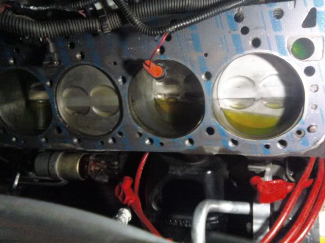

Well its not the bolts and its not the gasket. Much more serious. Pics below.
Cylinder #3 as i found it once the head was removed notice the piece of metal at the bottom resting on the piston:
This is the culprit. I have no clue what it was before. It is steel. Thats all i know:

Pic of the passenger side after the head was removed. The coolant must have made its way through the driver side intake valves through the intake manifold and then down the passenger intake valves... I noticed coolant in the intake when i took the throttle body off. Any other ideas?
Let me know what you all think. Also please check out my heads thread i just posted. https://www.camaroz28.com/forums/sho...d.php?t=698671 Im going to post another pic of the piece of steel next to a quarter so you can get a better idea on its size. Also any ideas on what it may be would be most appreciated.
