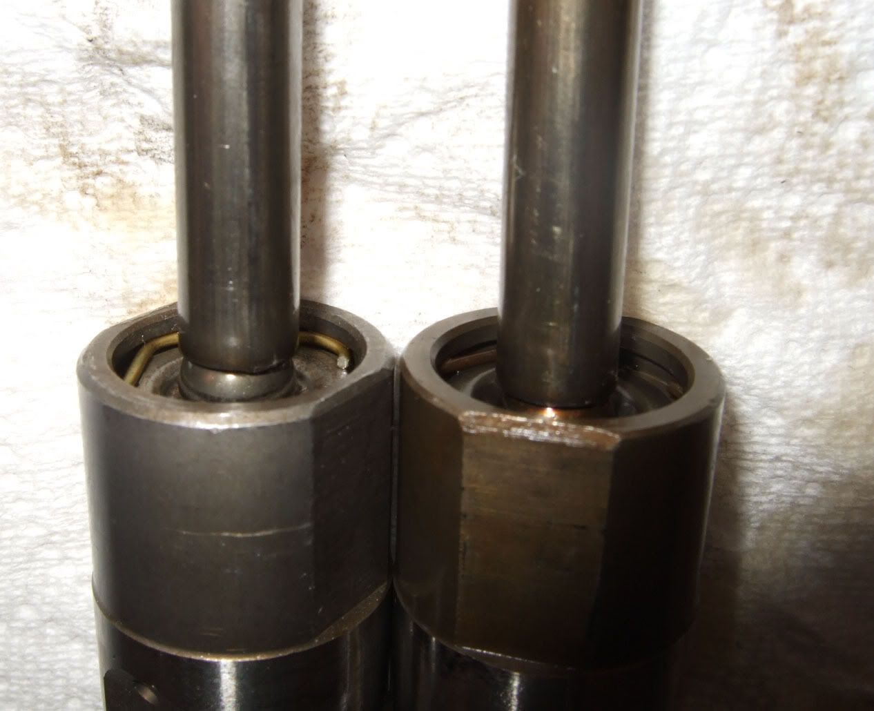

As you can see in the pics the LS7 is dramatically more shallow. I mic'd them and it appears at least .05 different. Now if you're running stock rockers then it probably doesn't matter but if your running 1.6 then it is certainly going to be too close to the outside edge of the valve head. The body, roller, and clip appeared exactly the same as stock, only the pushrod portion is different.
Ls7 on the left, stock on the right
Attachment 32889
Some LS7 lifters were lighter colored, some were dark like the stock lifter (dark stock lifter on the left)
Attachment 32890
Hal

Can you put LS7 lifters in an LT1?
Stl94LT1 May 29, 2009 02:46 PM
Yes.
BLKOUTZ28 May 30, 2009 08:04 PM
They work fine in mine.

bombebomb May 31, 2009 05:50 PM
They are the stock replacement for LT1's now.
meissen Jun 1, 2009 01:41 PM
I'm running LS7 lifters in my build right now with stock length push rods. LS7 lifters, comp cams hardened pushrods stock length, comp cams pro mag 1.6 roller rockers, fel-pro head gaskets, CC503. I went with them and stayed with stock pushrod length after I read on here that someone else was using stock pushrod length with the ls7 lifters.
