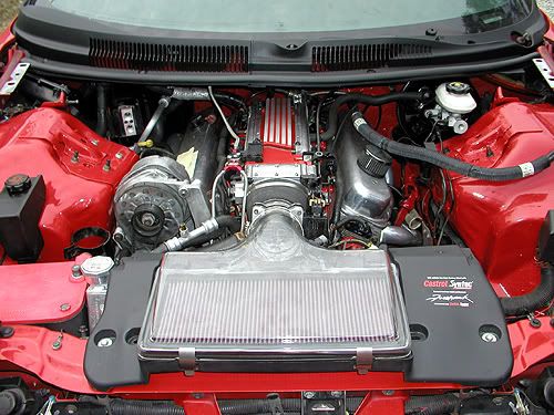

I didn't have to hack mine up at all, lol
[IMG][/IMG]
Don't mind the dirty engine bay fella's
[IMG][/IMG]

T/A kid, What kind of hood do you have? And where did you get the hose from the throttlebody to the mass air meter?
