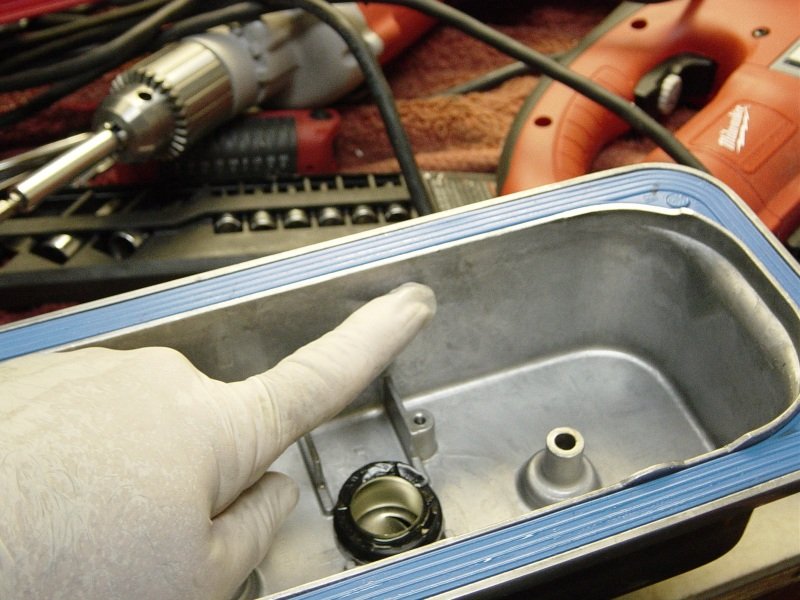

Is anybody running the Proform valve covers P/N: 141-131
These are suppose to be the taller valve covers. Can anybody post pics of what they look like on the inside? I have jessel ss rockers and I was told that they may clear. I was wondering what I had to mod on the inside of them.

Yes, I use that valve cover once in a while and it can be made to work with the Jesel shaft rockers.
The oil/air baffle needs to be removed.
The corner lip (intake side) needs to be ground down to allow you to push the cover toward the intake manifold (slightly).
The inside surface of the valve cover needs to be ground (the intake manifold side) to help clear the pushrod side of the Jesel rockers.
