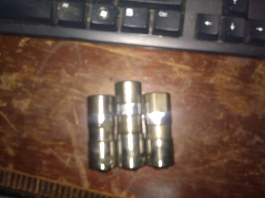

thats what i thought. but i bought these brand new from comp cams. thinking of just going and spending the money for a fresh box. i may have to take a picture of them.

Re: Lifter install
The middle one is what the rest of them looks like. The outter 2 are the shortter ones.

Re: Lifter install
That definatly will not work.

Re: Lifter install
Something is very wrong, there. Send them back for a proper set.

Re: Lifter install
i would send them back. but it has been over a year since i ordered them. So doubt they would take them back. I need to switch them any ways they are the comp r's that everyone has had a problem with. I am just going to get a new set. Any suggestions on a good ones? i was thinking of the ls7's

Re: Lifter install
OEM replacement/LS7s. They are one in the same. I'm running them in my 383.
