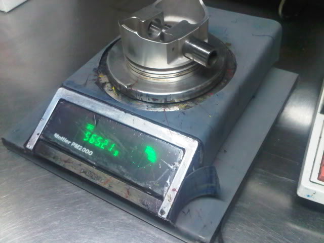

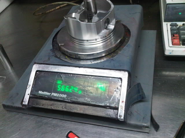

There is a difference in weight of 6 grams petween pistons. Will this difference offset my internal balance too much or is it tolerable?
Dish piston and wrist pin weight:
Flat top piston and wrist pin weight:

Nothing has changed in my thinking from that old post of mine you quoted. If I read that scale correctly you are only looking at a 6.52 gram difference in piston and pin weights. Again, assuming your motor was correctly balanced with your old rotating assembly "set up", adding that 6.52 grams in piston weight will NOT require a re-balance. But ....... if you really want to sleep better at night, try finding either lighter "thin wall thickness" and/or "tool steel" piston PINS through Summit or Jegs, rather than removing ANY material from your new pistons!

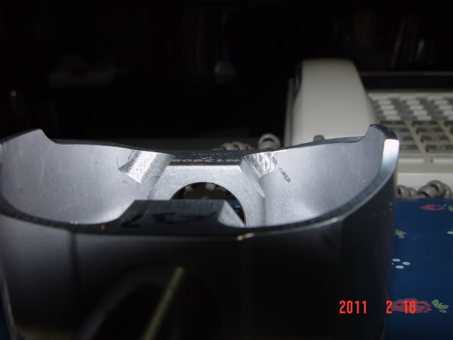

I was able to get this close to the desired piston/pin weight combination by switching to a lighter piston pin. I switched from 130gr to 115gr pins and this left me wit only a 6 gram difference.
I already milled the pistons a bit and removed about 5 grams of each according to the " Chamfer pin boss " style shown in the SRP standard custom piston features description.
This procediure got me 1 gr from my ideal weight. I think I am good to go:
