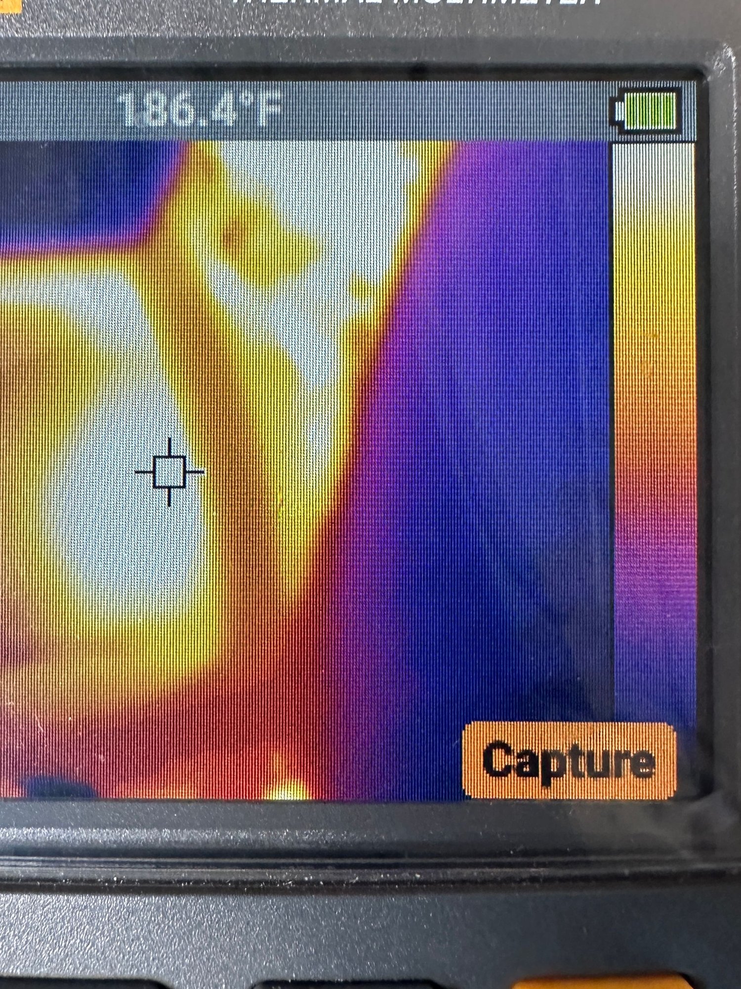

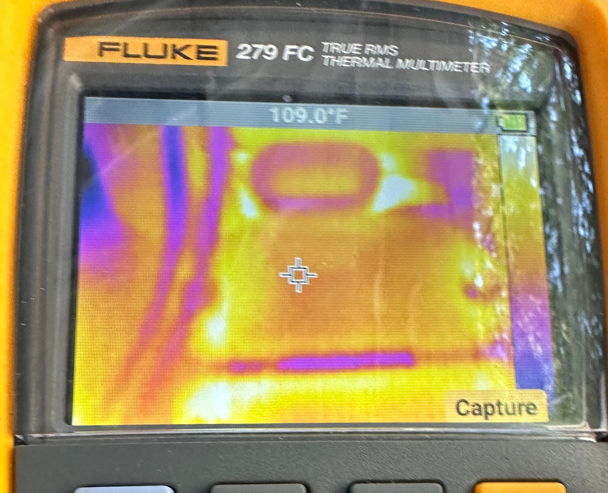

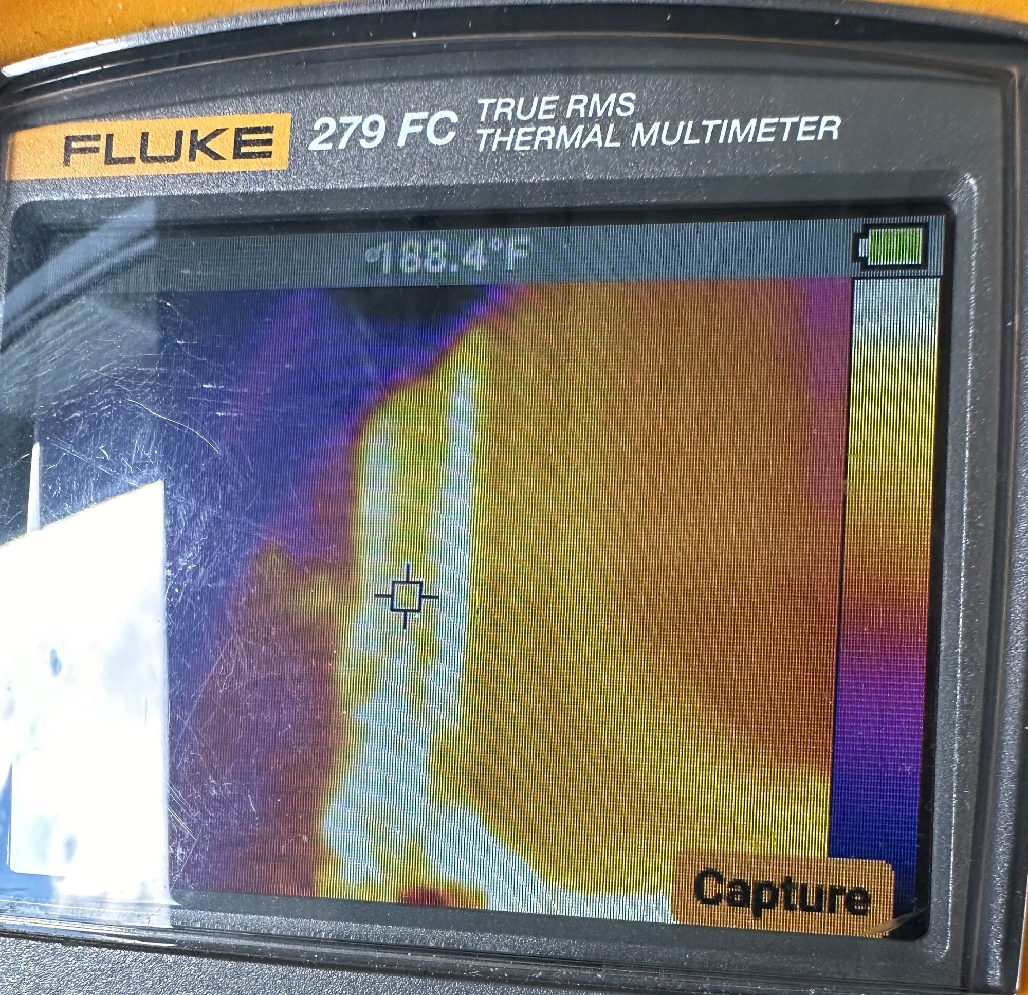

Previous post, I talked about possible ICM issue, resulting in:
1. Dying after extended idling - not being able to restart without waiting about 15 minutes.
2. Not able to restart after short shutdown (example, run into store for 5-10 minutes). Again, open hood and wait to cool down.
So, tried ICM touching head - ICM spaced off of head, ICM with heat transfer paste between every piece of bracket, blah, blah, blah.

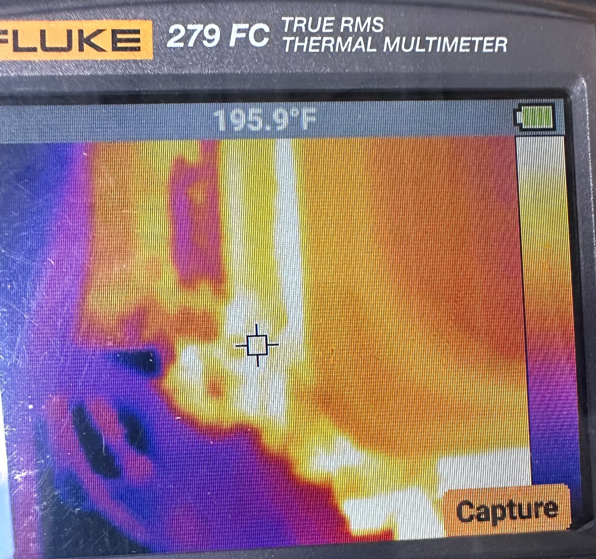

Used IR camera to see just what's getting hot and just how hot.
When warmed up, running, 93 degree day.
Cylinder head (where coil/ICM mounts), ICM, it's heat sink AND the coil, ALL 200-210 degrees.
After shutdown, temps slowly climb, as might be expected.
With, what seemed to me to be "junk science" regarding the cylinder head being a necessary heat sink to remove heat from the "heat generating" ICM,

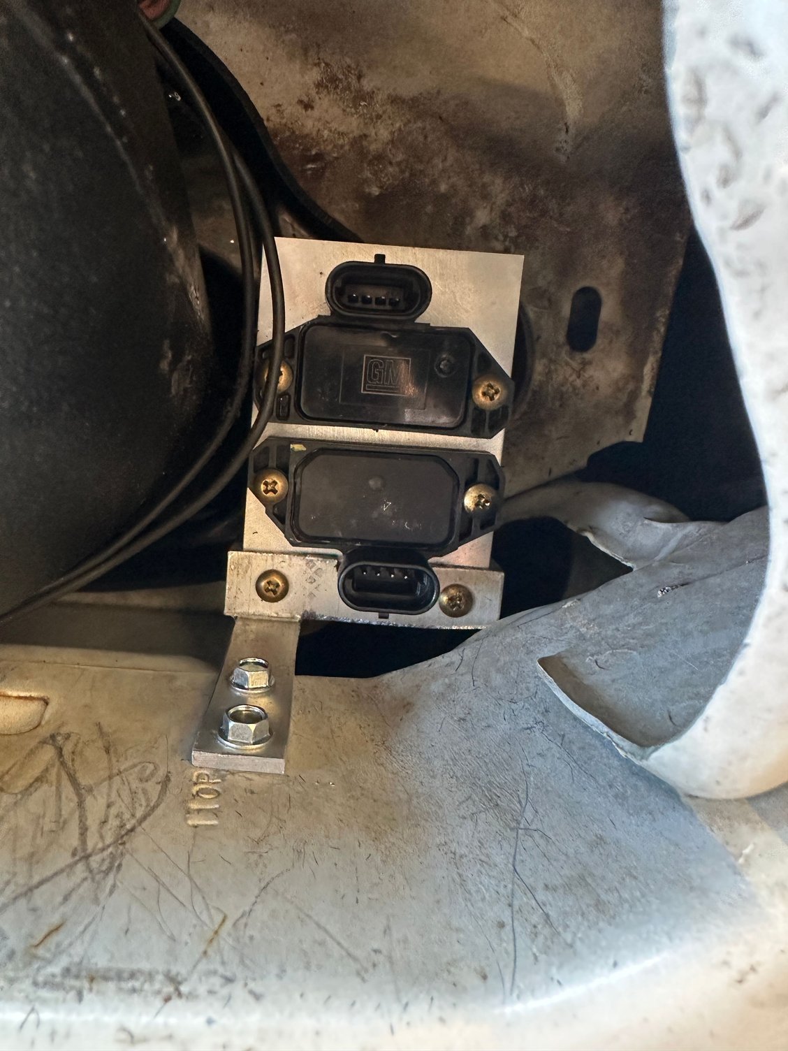

OR spacing the ICM from the head, I decided to just move it away from the engine.
Since I just installed a K&N CAI, these is a pretty good space available when the stock air cleaner lived (SS models have even more room)

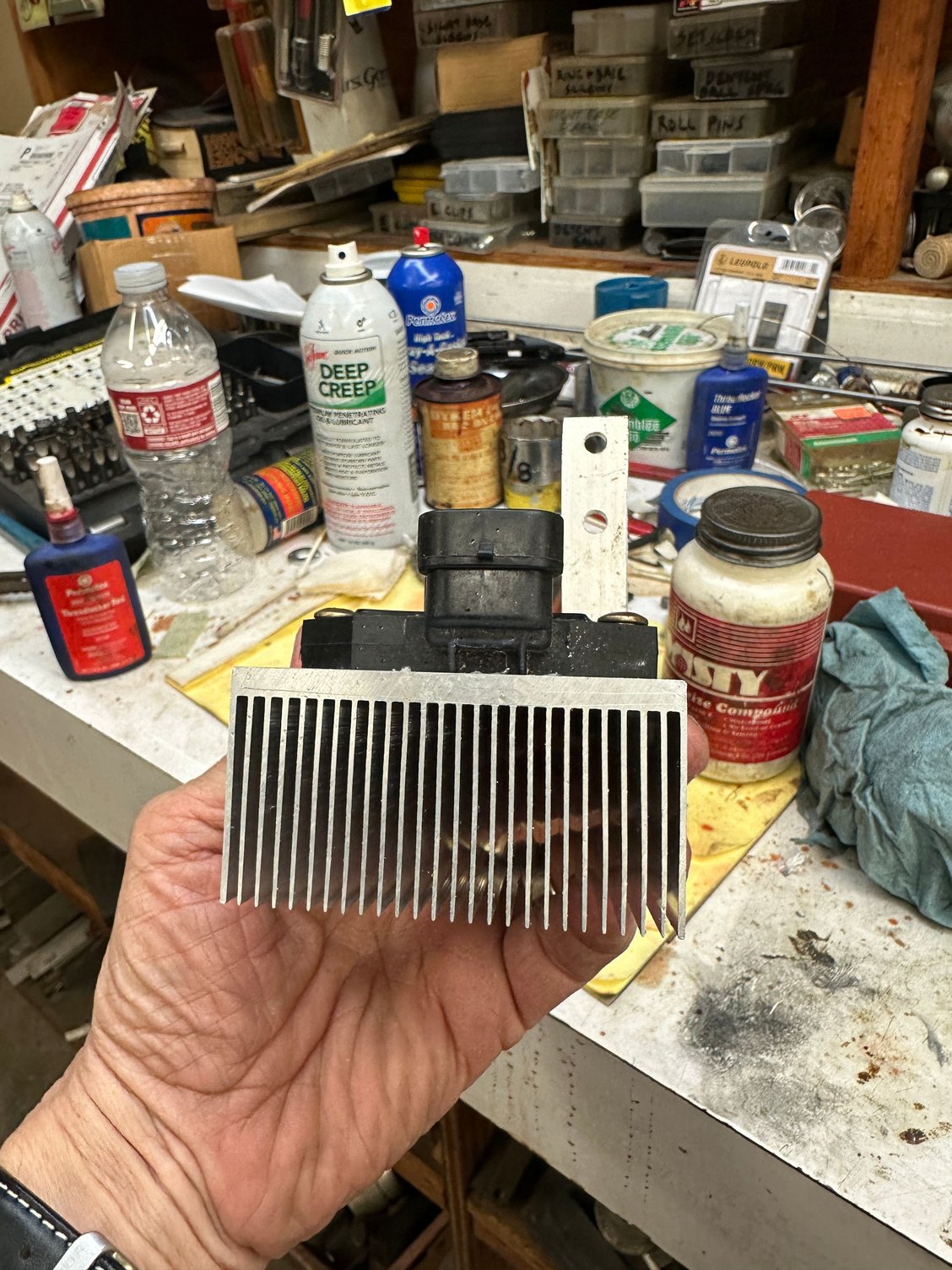

I bought an oversized, finely finned heat sink from Amazon and an OEM PT757 connector from eBay.
This would have required splicing in about 12-16" of wire to reach the ICM's new location (and 8 solder joints w/heatshrink).
I searched for the "female" connector (ICM side) but was not able to find.
Having bought a Casper Electronics 109068 Cooling Fan Control Module and seeing how nice their connectors were (inline, male and female), I contacted them
and "Joseph" said he could build me a custom extension for my ICM harness.

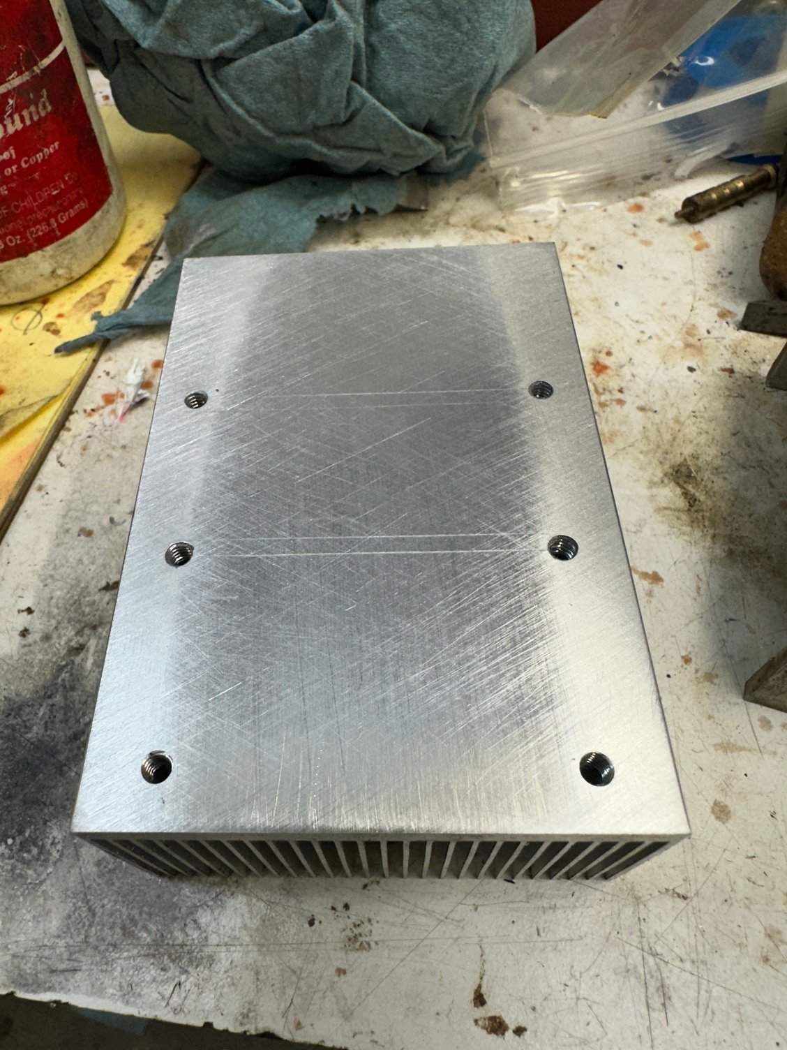

Just mounted the ICM to the heat sink, and build a crude mounting bracket from scrap at my buddy's shop (used his Bridgeport to drill & tap 8-32 holes for the ICM and bracket.
You'll notice I have 2 ICMs mounted. The "old" one was bought in July 23 and is 2 months out of 1 year warranty.
(Alternator from Rock Auto bought 8/31/22 - died less than 10 days out of 2 year warranty!!)
Bottom line...

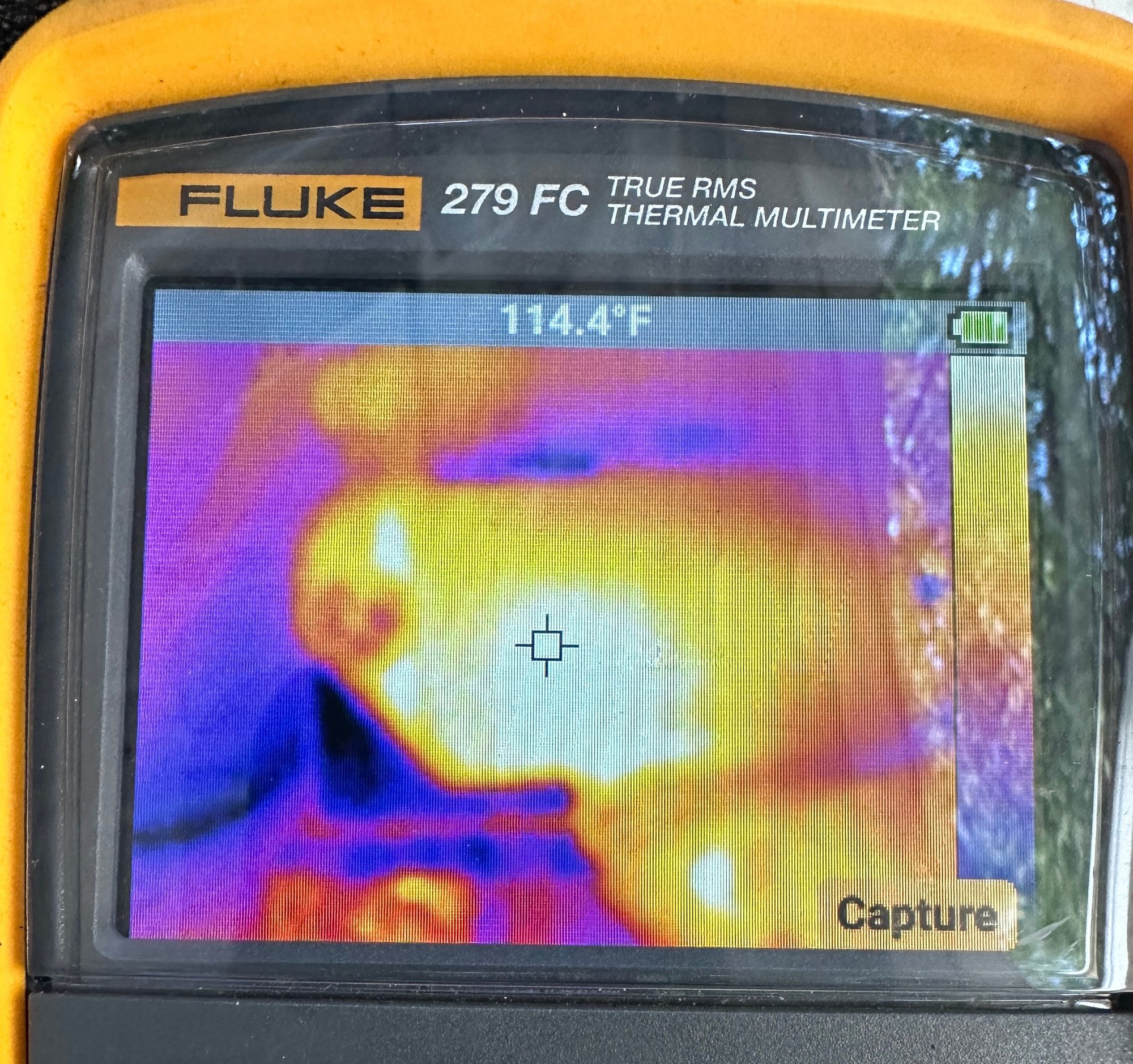

Today 90 degree afternoon.
Temp on "hot" (the one being used) ICM was 115 degrees. This right after pulling into driveway, redline 3rd gear pull offramp.
"Cold" (spare) ICM 111 degrees.
Cylinder head 188, coil 186!
Pics below.
Relocated to the path of air that was occupied by factory air cleaner (behind headlights).
“Hot” ICM, only 114.4 degrees!
“Cold”, unused ICM, 111.1 degrees.
Cylinder head, ICM area, running.
MSD Coil, running
Cylinder head, 5 minutes after shutoff.

That is a nice setup. Was looking to do the same, but trying this instead.
This is what i did. Should look at a bigger heatsink.  Also thinking of installing a 12v computer fan to either run all the time when running, or hook up with the rad fan to come on when they do.
