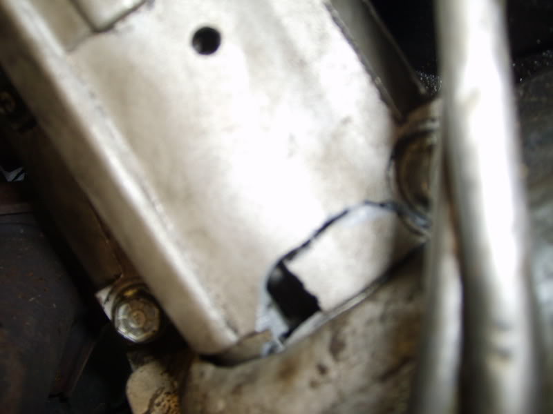

Picture of Broken Starter #2
********EDIT Never mind flexplate isnt broken. . I turned it all the way around and got a closer look. I dont see any cracks or anything on the flexplate************

So its not the flexplate. How do i get the stock starter lined up correctly if i cant see where the flexplate meets the starter when its on.
Old Aug 6, 2008 | 08:15 PM
cnorton's Avatar
Joined: Jul 2003
Posts: 553
From: Southern California
I sent you an e-mail about half-an-hour ago. It would seem that the problem you have isn't addressed by the experiences I've had. I suggest that you get more information from "red95chicken." I still think it's an alignment issue but it you can't see any indication of the nose of the starter coming in contact with the flexplate itself, anything I add will only confuse the issue. You need advice from someone who has experience with this specific kind of breakage.
Good luck,
c
Old Aug 6, 2008 | 08:20 PM
Projectcam94's Avatar
Joined: Jun 2005
Posts: 326
From: South Texas
Thanks for trying to help cnorton. I just sent red95chicken a pm about the problem.
A friend and i replaced the tranny a few months ago maybe like 6 months or a little more. Im thinking the bolts could of gotten loose. And if they are loose that would mess up the starters alignment with the flexplate
