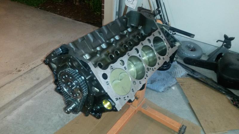

I was planning on a budget build and just getting the extra short block in my garage rebuilt, but I found a built short block locally from a fellow member and got a great deal on it. Thanks again cycletech. Now I'm trying to decide how I want to build this.

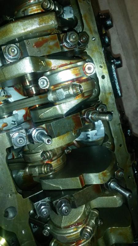

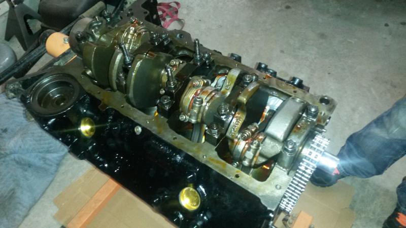

It's a never ran rebuilt zero decked and balanced 355 short block with 4 bolt mains, forged Icon flat top pistons, forged eagle I beam rods, a 10/10 stock crank, has Clevite h rod and main bearings, pistons and bearings have been coated by polydyn. ARP bolts and studs everywhere. Also has double roller timing chain by cloyes. There's a big carb cam in it now, not sure of the specs but I'll sell it after I pull it since I'm staying with EFI.

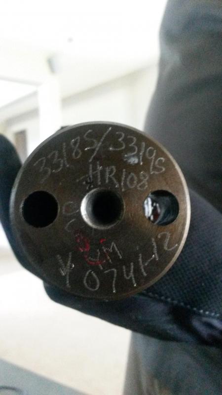

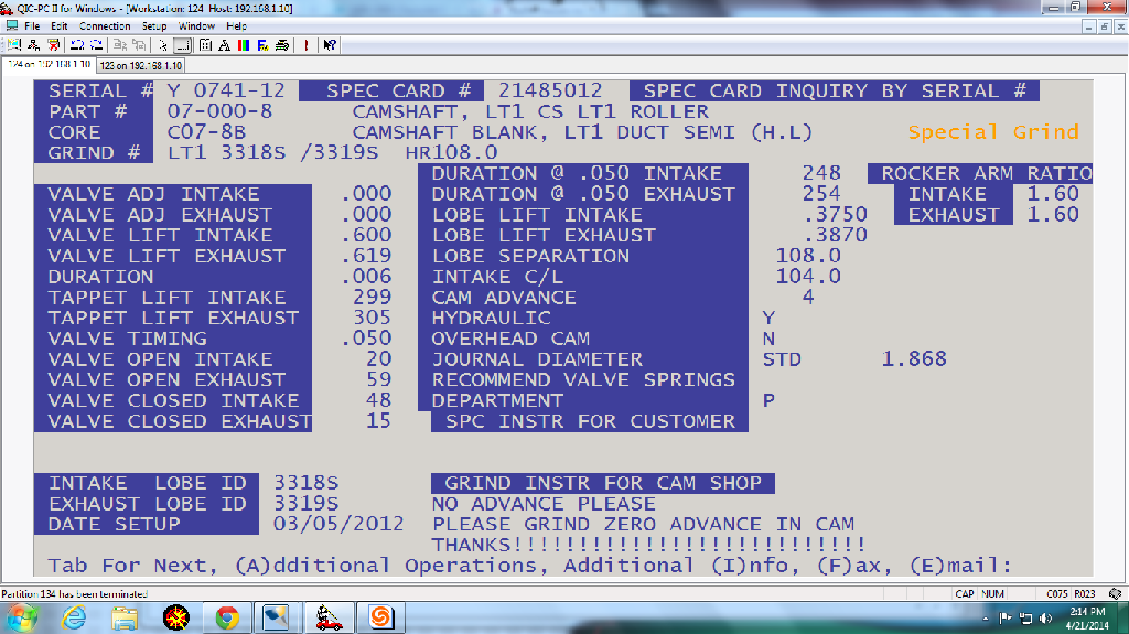

I pulled the cam and had comp check the grind. It is a 248/254 cam. If anyone needs a brand new cam or know someone that needs one pm me. I have no use for it. Way too big for my plans.
