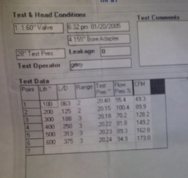

Not sure what the rear gear is. I used to know but I have forgotten. It's a 97 M6 so whatever came standard with that.
The ported heads from what I understand are top of the line.

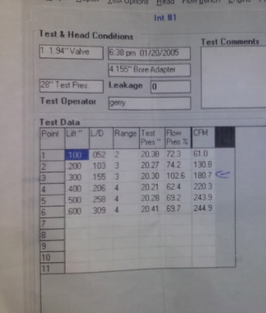

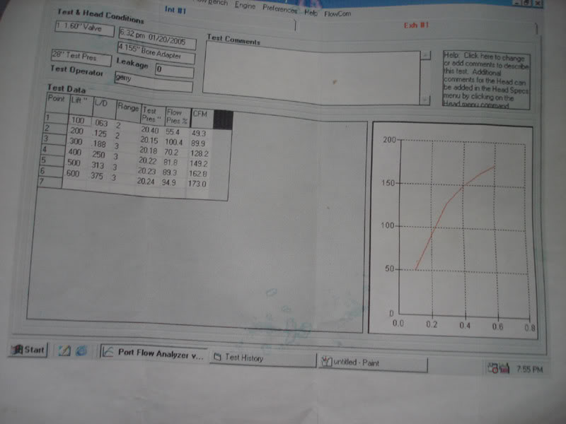

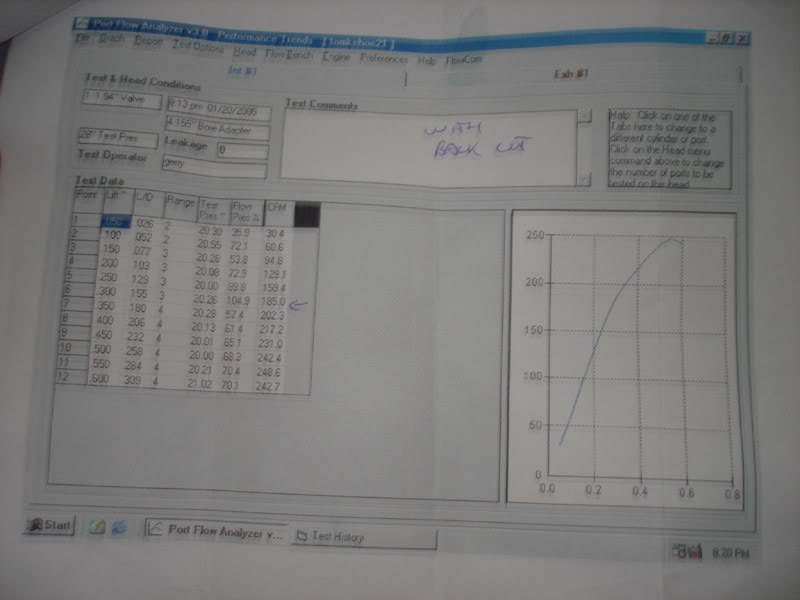

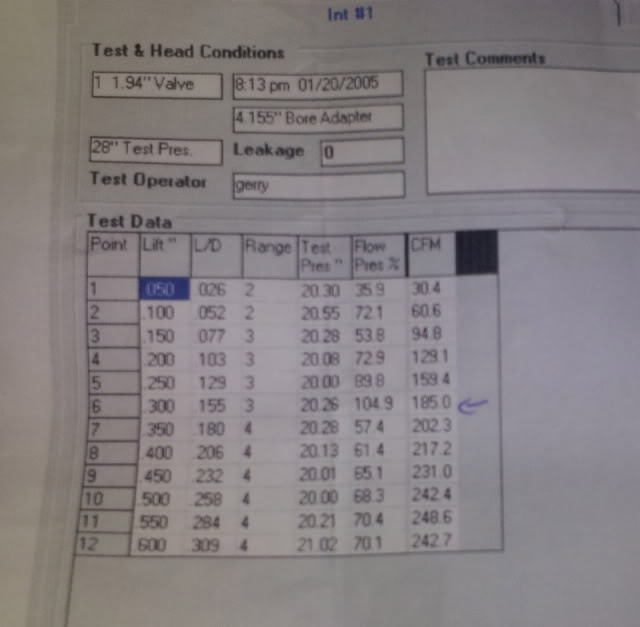

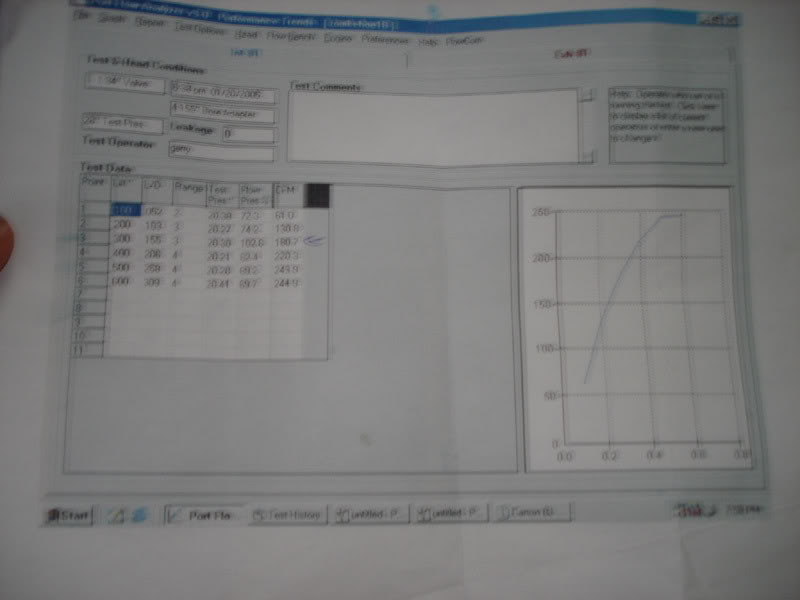

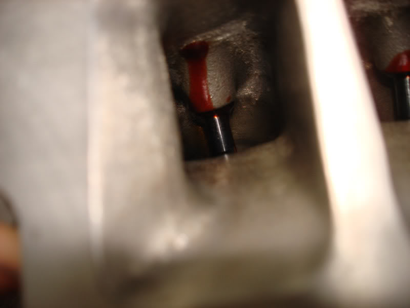

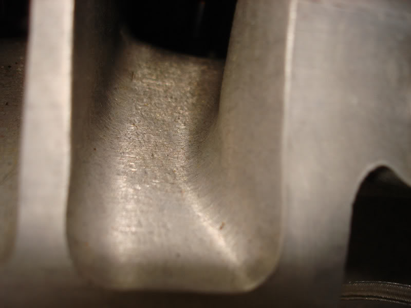

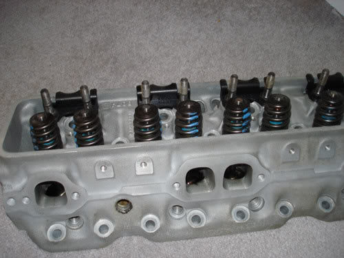

Some pics of the heads from 07 before I put them on the car...

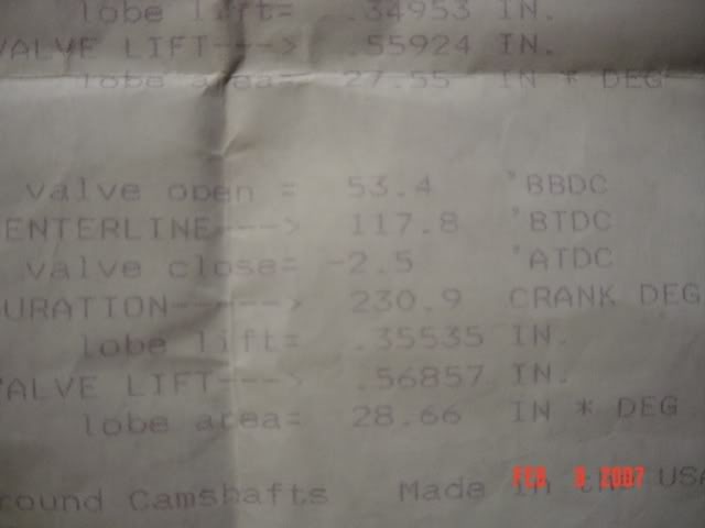

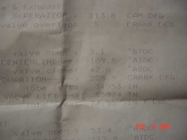

I have a cam card I will have to upload some pics of it it has all the details on it....
Old Apr 12, 2012 | 07:15 PM
raroz28's Avatar
Joined: Feb 2005
Posts: 1,326
From: Metro Detroit, MI
Re: Help choosing a cam...
My cam sheet...
According to this, the ICL is 110.

FYI I can't read a damn thing on those pics you posted of what I'm assuming is the head flow chart.

Ok here are some new pics I just took.
The cam card I have is almost blank from age.

Heads flow 248 by .550 then start backing up at .600? Not really a "top of the line" ported head casting. You'd want the flow to not back up on the bench to lifts much higher than .600 even tho you are running sub .600 cams.
But with that, I agree the 503 seems to be a nice cam. Wont be as smooth on a 112 as a cam on a 114 but it will make better mid range power.
Another cam to consider is the 268 XFI. Great little cam that makes good power and is extremely driveable although the lobes are abit aggressive and require good spring to control. 280xfi I've run in a friends motor and it wanted to go to 6500 rpm but had valve float. Needs good double spring 150lbs seat or higher and near 400 open to control but its a good cam, just abit big for what you need. Thats where the 268 comes in. Good bit smaller but still a good 350-370whp cam. 280xfi seems to be taxed at 400-415whp depending on the setup.

I have seen many charts where they are only slightly higher at .600 than they are at .500. Most flow charts I have seen only go up to .500 and many do not show the .550 so I can not comment if it is unusual to back up or not.
What I meant by top of the line is the guy who did them. According to him it is not so much about the flow number as the actually flow and design.

Those heads by flow numbers alone are comparable to stock LT4 heads. They are okay but by NO stretch of the imagination are top-of-the-line.
Top-of-the-line ported stock castings flow upwards of 290+cfm on the intake side.
