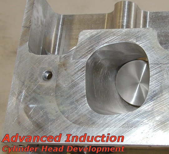

You’ve apparently been mis-informed. All top level racing heads (Nascar, ProStock, Top Fuel etc.) are CNC ported. If you’d seen the head castings you would quickly understand that teams would not be able to produce enough cylinder heads with an army of porters. They don’t start off anything like normal heads we are used to. How many top level guys are there around the country for every team that needs hundreds or even thousands of heads per year?
When I was down in Charlotte I took a quick ride out to pick up my 200’s at Ai & they let me take a few phone pics of some prostock heads. They hosted the best one, it's a 2” or 2.080” valve stuck down inside one of the giant ports. The valve would actually go all the way THROUGH the port & out the other end. The raw ports start out a little larger in diameter than a coin. Even if it were possible for one pro to work 24/7 they’d never supply enough heads to a top team. That still doesn’t touch the fact that there is no way a human, no matter how good you want to believe they are, is going to accurately duplicate a port as well as a machine. I like the fact that the machine doesn’t get tired or decide it doesn’t want to do as good a job for me. I know people claim who ever their favorite is is as consistent as a machine, but I think most people are smarter than that.
It’s sad so many people base a really expensive decision on what they read on here when half of the time the advice is totally wrong.
Here is the pic I took.
click for picture
