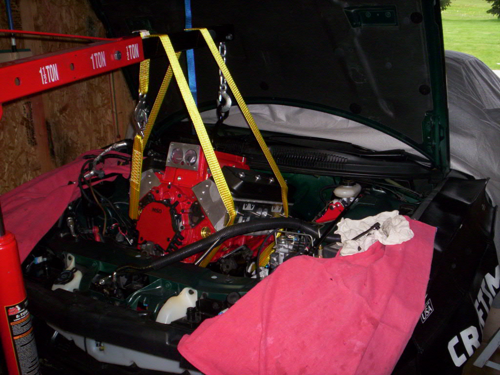

I used mine once when putting it back in again and it worked fine. It is scary with those tiny bolts holding it on, though. I would feel better with inserts in the intake although thread strength and bolt strength is really pretty high. Like Slick said, I'd make sure those threads & screws are in good shape and don't over tighten the screws when attaching it. You can see I was insecure about using it for the first time and used some safety straps that got in the way.
