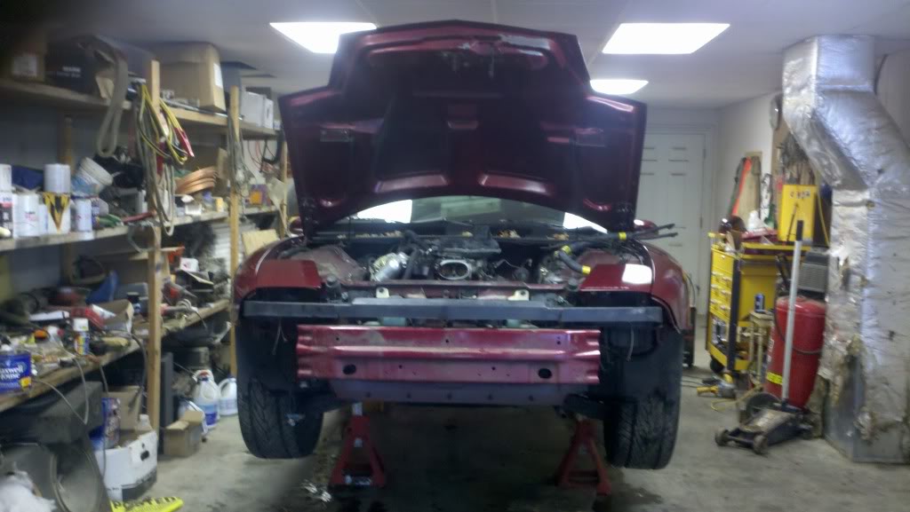

I know you expressed no interest in going through the bottom but it is extremely simple. I just did mine yesterday and wanted to share this. my front cover was already off since I am replacing the header but it is not necessary as previously stated. i started on the ground and removed all necessary components.

Old May 8, 2011 | 08:50 AM
drennon1's Avatar
Joined: Sep 2010
Posts: 61
From: Louisville, KY
Re: engine removal out front?
Now an hour later I raised the car on jack stands in the front and some wheel ramps in the back. Then removed everything else that is needed.
