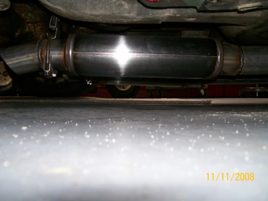

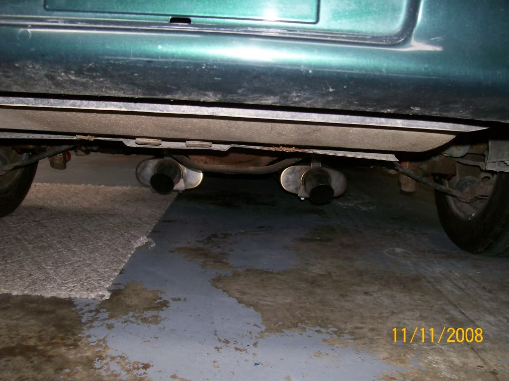

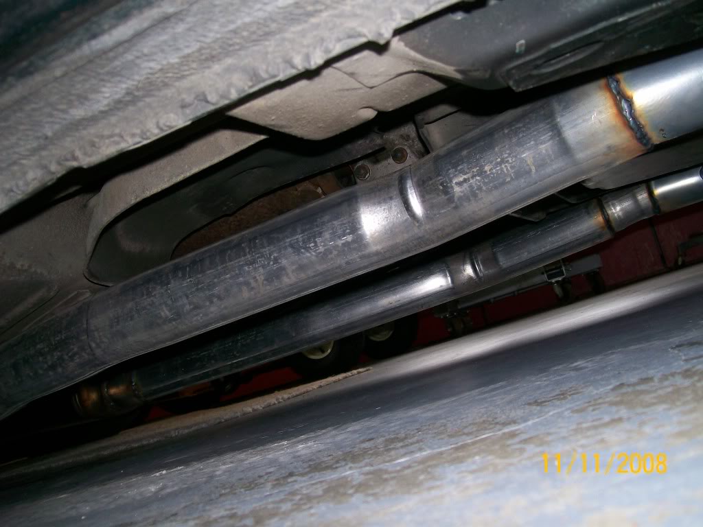

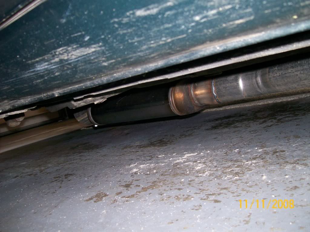

Exhaust was put on today, this seems to be the last part of the build. So this will more then likely conclude this thread. But not without some pics, I will try to get better one's later. No H or X pipe in this set up. Id say we have about 3 inches of clearence.

I will edit this post with sound clip tomarrow.
