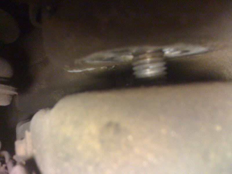

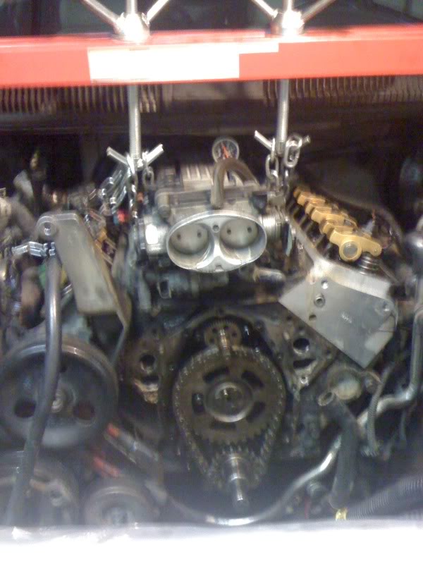

The threads showing in one of the pictures is the passenger side k-member bolt closest to the front of the car. The first picture is the passenger motor mount and the second is the driverside motor mount (sorry for the upsidedown camara angle). not sure if it helps anyone but pictures sometimes make things easier.
