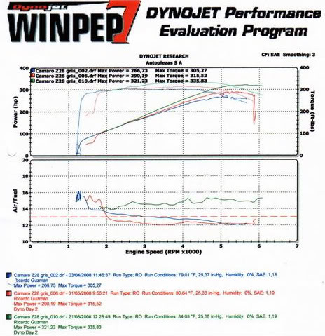

The first graph (blue) shows Hooker LT's, stock cam, stock catback. 266HP 305lbs/ft
The second graph (red) shows the result of adding 1.6 GMPP roller rockers, hotcam springs and Borla 3"catback. 290HP 315lbs/ft
The third graph (green) shows the result of adding the GMPP hotcam. 321HP 335lbs/ft

Disregard the third A/F graph. the wideband was not up to the task that day.
this was on my '97 M6 Z28 with a Strange 12 Bolt
