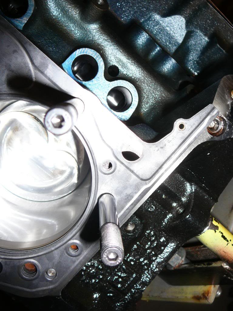

So I'm putting my motor together and noticed that the front and rear top coolant passages on the block don't match up to well with the gasket passages. Here is a picture to clarify.

Are these the wrong gaskets or something. I told them LT1 when I ordered. Here are the numbers off the packaging. C5245-027, H1074, 235593.

Turns out I was sent SBC gaskets. FBO is taking care of me though and exchanging them for LT1 gaskets.
I was gonna say, those don't look like the correct gaskets.

Definitely not LT1 gaskets. That would have been a mess...LOL.

Um ya, that one had my head turned sideways
