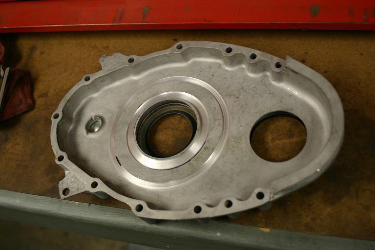

I've been using no gasket, and grease. I think I finally got it all cut out. Although I didnt grind right around the opening for the opti, most of mine was done where the chain is. Basically taking out the plateau around the outside of the opti hole. Here is a image of where I have ground. Is this where it usually rubs? I didnt think it was hitting closer to the opti whole...

Here is a pic I took when I checked for rubbing on my cover with grease.
Jason
Old Jan 22, 2007 | 12:21 PM
Javier97Z28's Avatar
Moderator
Joined: Dec 1999
Posts: 3,853
From: Jupiter (NPB), Fl
Jason
holy overkill.
a little grease on the chain would have done the trick lol
