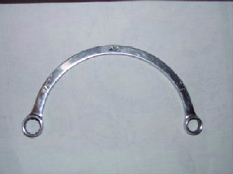

heres the little devil you need. mac hm1214. it would be a wonderful world if we had access like that to slide that allen wrench into those breslin bolts, prolly could get at half of them with slp headers.

Grumpy, where do you find that wrench. I take it it arches over the primaries to get better turns in. How about the fitment of the wrench head between the bolt and primary, do you still have to shave some of it off?

interesting pic Grumpy... is that a wratcheting wrench?
How much does one of those babies run?

ouch... just found them on MAC tools online catalog.
5-piece SAE Half Moon wrench set: ~$205
5-piece Metric Half Moon wrench set: ~$150
Neither set is ratcheting though. (yeah I'm lazy )
I'm gonna try my racketing Craftsman wrench and the ARP undersized heads first. (cool tool though, can't recall seeing one before)

nah-its a full manual control high performance overpriced chrome tooltruck suppository, but it do work-a ratcheting head would make the od too big and we would be back at square 1.
