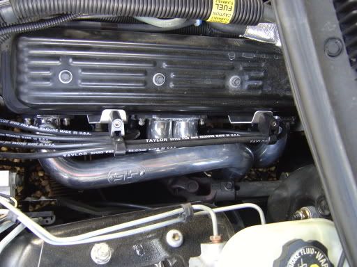

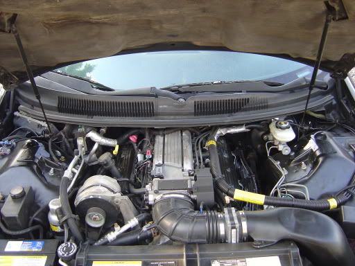

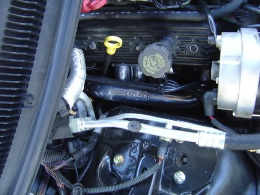

They are on now and it runs OK. The drivers side O2 sensor is too short so i just ordered a 12" extension, and im still waiting for a tune from ion. I had to take it to a muffler shop to bolt on the Y (need some low profile sockets or something because i couldnt get it on) and they also welded on a 3" cat, they said they couldnt do a 3" pipe with a flair to bolt on to the cat back. But thats fine because its lowder then it was before but i didnt want it too loud. I found it annoying driving to the muffler shop with stright headers.
Ill have a video that ill put in the sig when i get the rest of my parts, i just have a couple pics for now. Like i said earlyer, plug access isnt bad except for #5.
For future refrence, anyone wanting to put 93 SLPs on their 95, you need a 12" O2 extension and before you put the dip stick in sand it down, its even harder to put back in then it is to take out.
