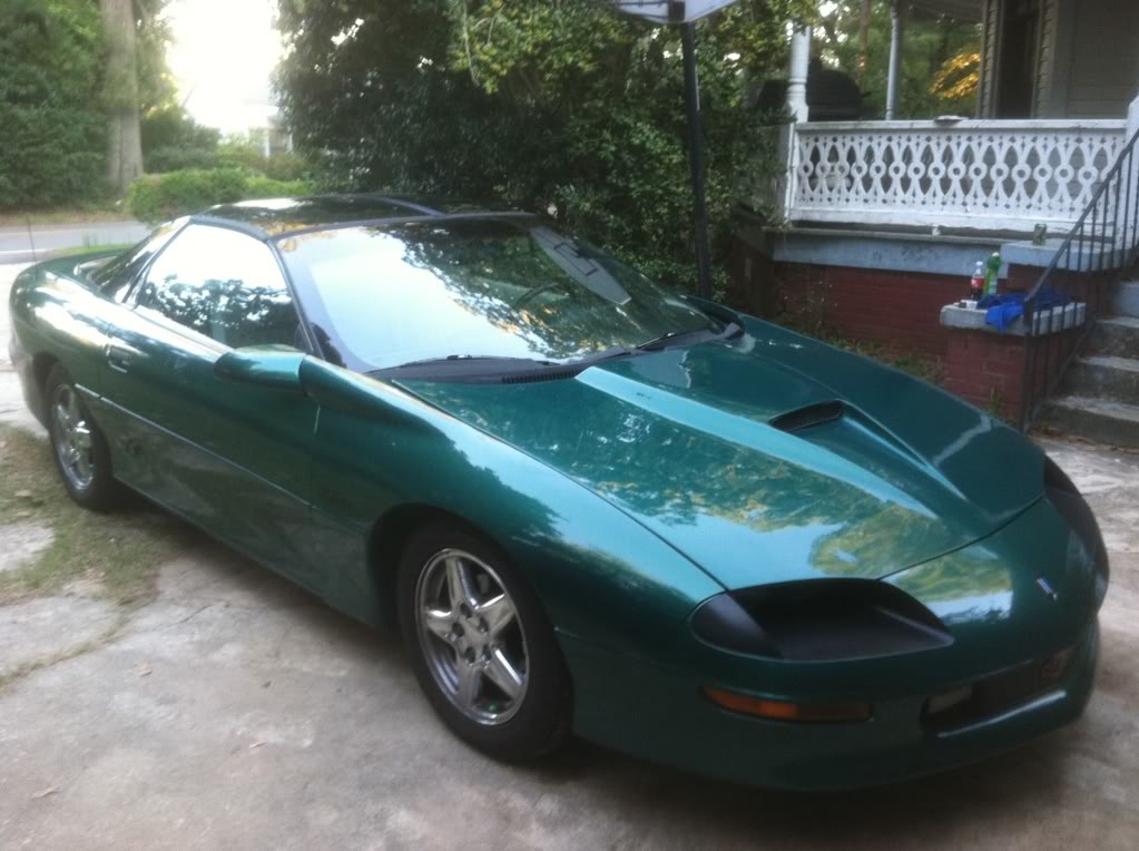

Hey guys I just got this Z28. Here are the specs:
270k miles on frame
at 180k lt1 was pulled, block sent off and rebuilt. LT4 conversion was made (Not really into LT4 though but shes pretty tough ) All GM Performance parts
T-56 was rebuilt, new clutch et cetera.
GM performance custom pcm for LT4 swap
EGR was deleted
Cats were pulled off, leaving rear o2 sensors and egr pulling a code.
Has a optispark 2
stock 3:42 gears
K&N/holley cai setup
BBK throttle body
Corvette Injectors
The problem Im having is, a rough/high idle. I finally had time to drive it today, and check it out but havent gotten it on a lift yet to do full inspection.
@ idle in neutral its running 1100-1200 rpms (normal? I dont think so), I can also tell while driving it is idleing high as well, at 60 in 6th gear im at 1500-1600 rpms. Also while driving if i press in clutch and put it in neutral sometimes rpms dont drop they either stay where they are or even go up (WTF??)
I can also tell it is running rich, i can also smell gas around the filler neck, and when I took off gas cap it was under a lot of pressure???
Also it has flowmaster exhaust w/ no cats, and it is loud but not good loud, sounds kinda sick but someone told me its the stock rectangle z28 tips that make it sound bad.
Also heard belt squeaking and its a new belt, i investigated and it appears that the harmonic balancer is like shaking n stuff not running smooth??
PLEASE HELP ME DIAGNOSE THESE PROBLEMS, bc this is now my daily driver ( i traded a 05 dodge neon for it lol)

If it's idling high I'm betting that there is an intake leak(or unmetered air getting in) somewhere. I suppose it could be some type of IAC issue as well.
Is the SES light on?
Have you scanned it yet with an OBD II scanner?
Normal idle is 800 rpm.
Some pressure when removing the gas cap is normal. It shouldn't be blowing out of your hand, but there is a distinctive "sssssshhhh" sound when I crack mine open to fill up.
The rectangle exhaust outlets have nothing to do with the sound. It's the muffler/cats/exhaust manifolds or headers that concern how it sounds. Do you know what series flowmaster is on it? I have an 80 series muffler and it sounds good. You'll hear lots of static on flowmaster mufflers here, but it has not hurt how mine runs(at least with my current setup).
I think it will smell worse without the cats, but I have not run without cats so others without them will need to chime in.
If you are having belt squealing issues it could be the tensioner, but a Goodyear Gatorback belt solved my belt squealing issues(on both my 1996 Z28 and 2005 Nissan Frontier 4x4). If the damper looks in bad shape, do get a new one. It should not be shaking. Is it mounted correctly?
You mentioned the LT4 conversion....do you know what cam is in it? Is it the LT4 cam or LT4 hotcam? Is your intake red or sliver? Do you have a detailed list of parts that were used in the rebuild?
Is the car lowered? It looks lowered in the picture.
