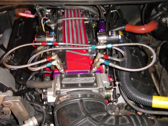

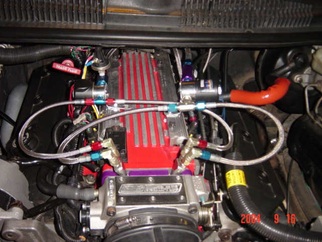

Here a better tip. The 94+ fuel line assemble are only $17.00 for Sam Taylor GM part# 10258441
Here a before and after pic:
BEFORE
AFTER

Correct part # is 10258441. You get everthing for where it connects under the car to where it connect to the fuel rails. All three lines, heat shield, and gromet thru fender well.

Not hard at all. They connect right under the car near the driver door. You need the take out the inner fender lining and everything go thru that gromet hole. Make sure you pull the clear tab off the metal lines, because the new line already have them. Also be low on gas when you start.
