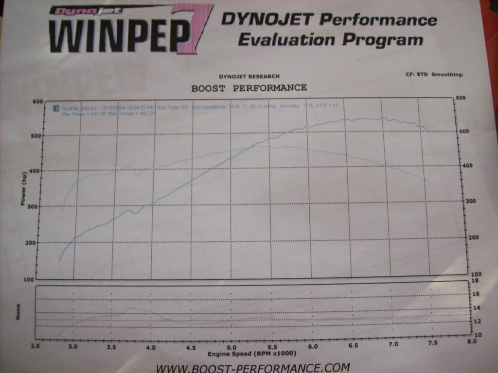

Just dynoed the car tonight again, i did some tuning and it picked up a little. 21hp and 28tq over the last dyno.
There is still more in the tune, just need to spend some time on it, headed to Dallas tomorrow for some TNT only 6 hrs away, I'll post the graph when i get back in town, hopefully with some new numbers too!!

541 rwhp 463rwtq
385 LT1 13.0 Compression
Dart LT1 Pro 1 heads , CNC by Bauer Racing
Bauer Custom Solid Roller Camshaft
Jessel Belt Drive, and Distributor
T&D shaft mounts
Kooks 1-7/8 headers
T-56 Faceplated
Moser 9" 4.71 Gears
28x10.5S Mt ET Drags
FAST XFI
The first pull tonight the car did 505 hp 435 tq , it ran 10.64 at 130mph in 3700ft DA , i'm hoping it will low 10's in 1000ft DA tomorrow with the Extra hp.
I'll post when i get back sunday.....

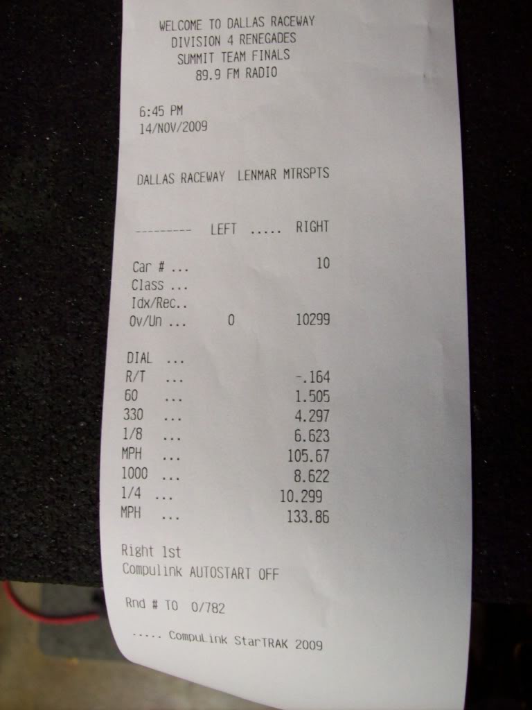

Thanks guys its been taking some time to dial in the dyno numbers , not the track times are coming around too!!!
Just got back from Dallas Raceway, the DA was 1900-1500ft
Car went a
10.44 @ 131.7 1.47
10.46 @ 131.08 1.48
10.49 @ 127.46 1.49
10.395 @ 128.59 1.47
10.299 @ 133.86 1.50
Again these times are All Motor and with a Faceplated T-56
