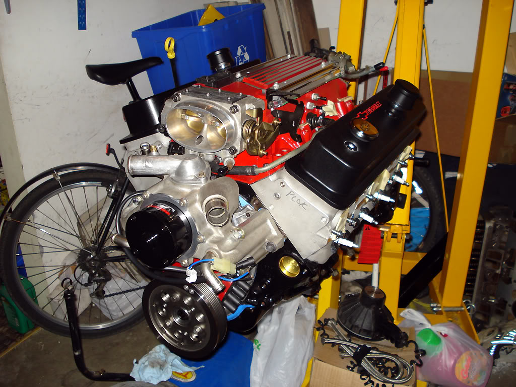

finally got my LT1 motor home on friday after several months of building it up slowly at the machine shop. spent a few hours on friday night and today going over things and bolting stuff up. not much to tell but the specs and plans, its going into my 95 camaro backed by a 4000 stall 4L60E, eventually id like to run a small shot of nitrous on it but it doesn't really need it, its just gonna be a wicked pump gas street car. i was going to engine dyno it to break it in etc. but we could not locate a carb manifold that would bolt up so ill have to wait for a chassis dyno session in the future. the motor will be 500+hp and 500+tq though, guys that run this combo put around 450 RWHP n/a should be a fun street car thats for sure.

SPECS:
- 383 CID factory LT1 block 4.030 bore, 3.75" stoke
- pro gram splayed billet main caps
- lunati sledgehammer forged crank converted to full internal balance
- scat h beam 6" rods
- mahle pistons flat top -5CC valve relief
- 12.4:1 CR 94 pump gas
- Advanced Induction 200cc CNC LT1 heads 2.00/1.56 manley valves, PAC beehive springs
- AI race ported factory LT1 intake
- AI custom billet hyd. roller cam 23x/24x .605 lift I/E 108 LCA
- jesel shaft mount 1.6/1.6 rockers
- GMPP lifters/hardware/valvecovers
- powerbond balancer
- MSD opti
- BBK twin 58mm throttle body
not pictured:
- ford motorsport 42lb/hr injectors
- pacesetter ceramic coated 1-3/4 to 3" headers
- TCI flexplate SFI
- LT4 starter/alt/ps pump
- alt relocation bracket
- MSD coil/wires

wondering where you got that balancer at?
its a powerbond SFI one, the hub is from them also.

Did AI give you the head flow numbers, port and chamber CCs? If so, do your mind sharing?
Jake
West Point ROCKS!
chambers were cc'd to my specific combo at 56cc the intakes are 200cc with 2.00/1.56 manley valves, peak headflow is about 290cfm on the intake, 200cfm on the exh with no pipe extension whatsoever.

Very nice setup! just dropped in my 383, 195cc LE heads, similar flow put down #'s in sig. in a m6. your build looks very promising! we'll see though, a4 and that stall are pretty power heavy. also, what oil pan is that? and are those valve covers clearanced for the lt1 alt?
hope your not running the stock 10 bolt!
the oil pan is stock LT1 with some clearance for the longer stroke. the valve covers are stock i will be using a custom alt relocation bracket from speed inc.
