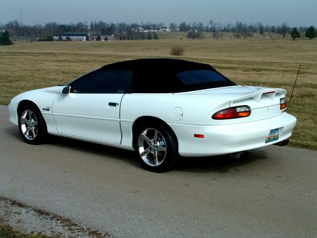

1 convertible to another looks like you did a really good job putting this thing together. I am trying to do almost the same to mine. I have a set of kbdd sfc's that I have yet to install and that will be my final suspension piece (until I change my mind). I believe that you have the same ones. Anyway great job on your car and I hope that you enjoy it a lot.
