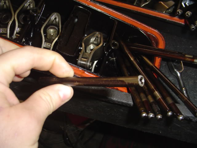

If they are hardened, I though '94 was the last year for hardened pushrods, they are a 3-piece hardened pushrod, aka still junk. You can reuse them, but I would advise against it.
Here is what stock 3-piece hardened pushrods do:
I also have a set of Comp 3-piece ('cause I didn't know any better) hardened pushrods that look very similar.

I can agree with the above post, 1 piece are way better that the stock 3 piece, but 3 piece hardened pushrods aren't junk. If your valve train is setup right, and you dont accidentally downshift, 4th to 3rd instead of 4th to 5th, you shouldnt have any problems.
What caused the above damage to the pushrods?
