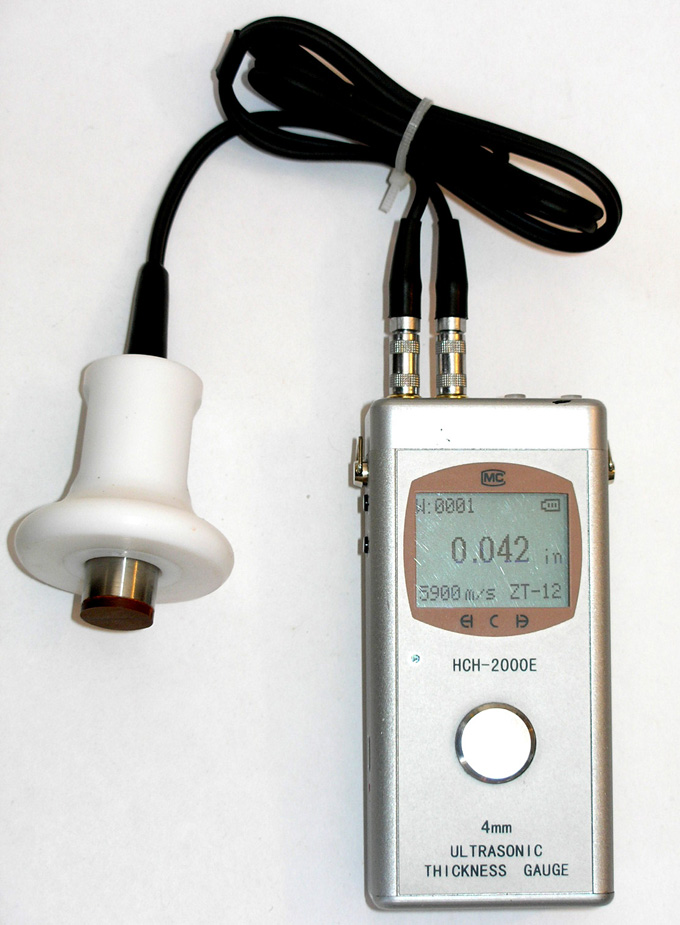

Old Mar 2, 2006 | 10:41 PM
  #52
1racerdude's Avatar
Joined: May 2003
Posts: 6,661
From: LA (lower Alabama)
Re: .060 over
Originally Posted by blackztpi
what will happen after it's run? i mean specifically. the shop told me they could try the .060 overbore and see what happens. he said he can normally tell by inspecting it if it will be too thin or not. i'm not too worried about cooling issues... the car runs cold as it is....but i don't want it falling apart on me. btw, how much is a sonic check?
They take one of these and check the thickness of the metal,kinda like sonar.
It will cave in or crack if it's too thin. The car running cool now don't count with thin wall's, it WILL run hot.
I charge $150.00 some may be cheaper if they are doing your machine work.

If it gets thin(less than .150) it WILL run hot.
Read the post M1 just made a couple up.
There is no way on earth to tell by looking if it is too thin. Ya will damn sure know it when ya fire it up.

That's the one I have.
how much is it for a sonic check?
A half way decent one is 450.00-500.00 dollars and then the probe that comes with it won't do all the jobs so another 100.00 for a smaller one.
Ya can find them on eBay but ya better do research to see what they are and what they do. Some are only capable of measuring thin stuff and ya don't need one that stores 100,000 measurements.
