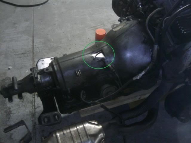

what is this tube on the 4l60E? (pic)
Old Nov 21, 2009 | 10:13 PM
GhostZ28's Avatar
Joined: Sep 2005
Posts: 1,326
From: Tulsa, OK
What is this thing for? Id imagine it has a purpose but it was so caked on with grime and oil that I didn't even know it was there until I cleaned it

Air vent because it has a sealed dip stick.

That vent should be connected to a rubber hose that runs along the torque arm.

Haha what rubber hose? You must have actually ripped something off or like me it didn't have one in the first place. When I reinstall it should I re-hose it and run it along to torque arm? if so where should the hose stop or hang from? or does it really even matter?

I never re-routed anything on mine, no issues yet.
