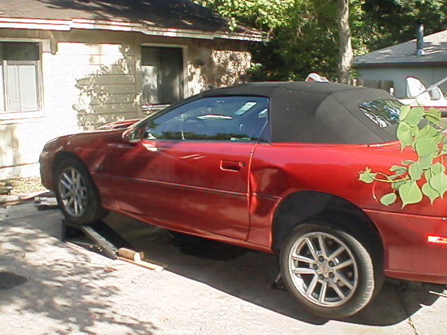

You can see a picture of mine here.
http://2002.cz28.com/SemiDamaged.jpg
You'll probably have to cut and paste though. I used two equal sized 1X8's and two equal sized lanscape tembers. But you can use any size lumber for the top piece. Just nail them together. Since the 1X8 is so thin, they won't slide. Then the weight of the car is on them so they won't slip when you hit the thick section either. Once on the thick section, slide any sized ramp you want up to the end of the jig. Drive right up, no sweat.
