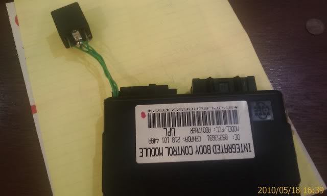

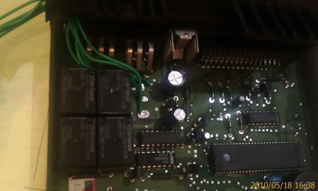

sooo it probably is the ignition switch. I checked the BCM for cracked soldier joints and tested the relay that has frequent soldier issues. That tall relay was engaging but the contacts weren't conducting. Then to make things more fun the electronics store said it would be 8+ weeks to get another, so I ghetto rigged it.

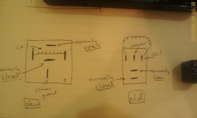

For all those out there with a weird window/dash/radio intermittent issue, this is probably the best fix for you! I removed the old relay, and went and bought a standard 30amp relay. The new larger one is 82 ohm and the tall original one is 90 ohms so there shouldn't be any signal strength troubles. The new relay is much larger and won't fit in the BCM case, so I drilled a hole and soldiered wires to all the leads to remotely mount it. Make sure if you do this to get the coil, common, norm open and norm close leads correct (i drew a diagram)

edit: I imagine all the other relays would be standard as well. To test a relay, un-soldier the relay you want to test. Get your voltmeter, set it to beep, and alligator clamp to normally open and common. take a 12v battery (a small test battery) and engage the coil by putting pos to one coil lead and neg to the other. the ohm meter will beep if the contacts are working. test normally closed by putting the meter to common and normally closed without the 12v battery attached.
