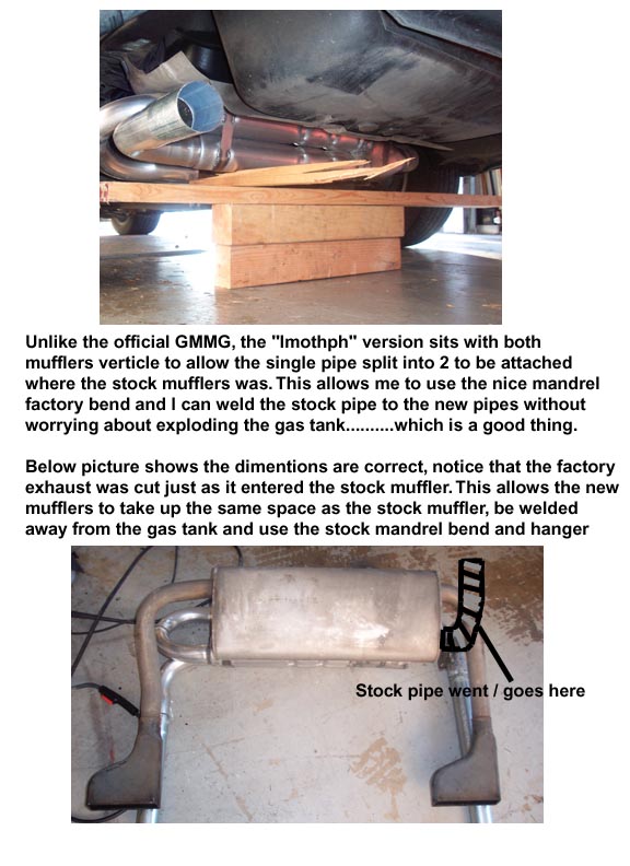

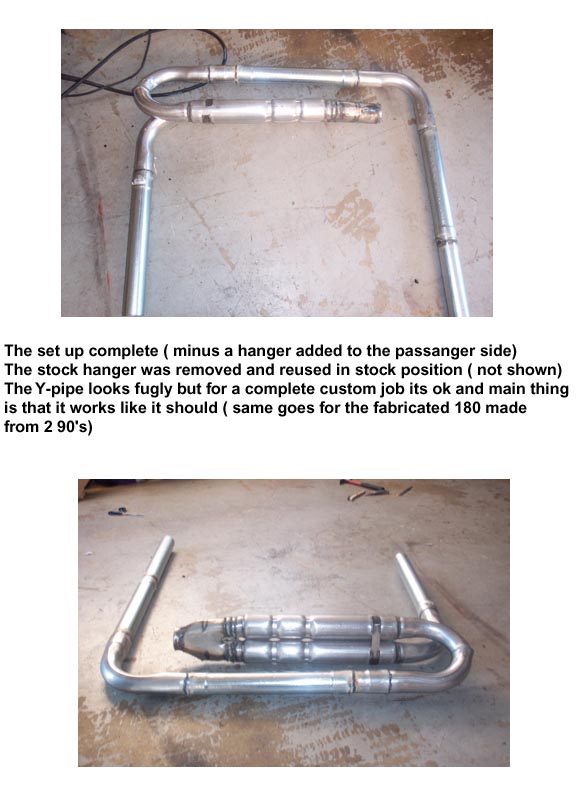

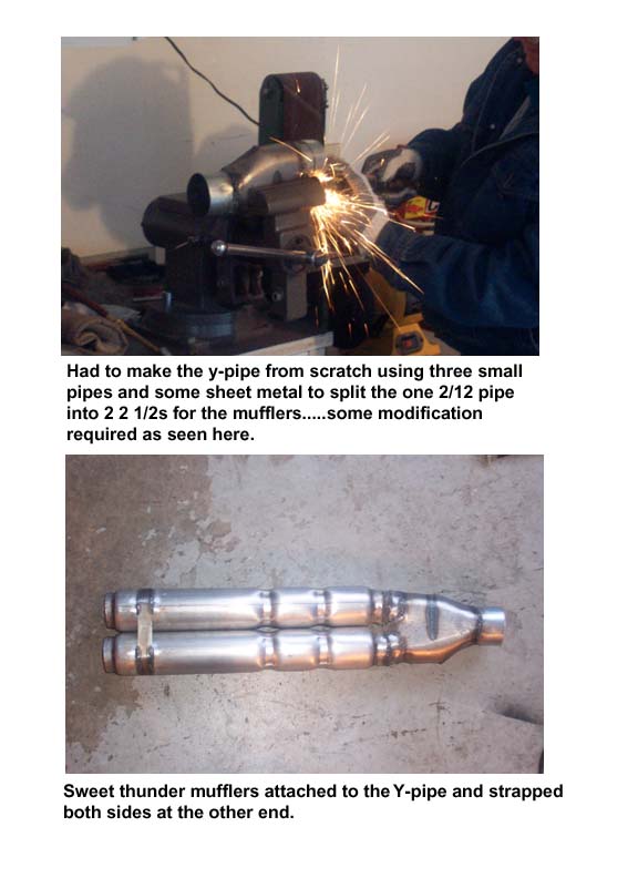

I decided paying $700 for the "official" Gmmg chambered exhaust was just a little too much....so.....I purchased two 18" Sweet thunder chambered mufflers and went to the local parts store for some extra pipe. Now If I were to do this again I would order the mandrel bent pipes in the exact dimentions but as it happens its just as well I didnt because my design changed. To copy the exact GMMG design proved too difficult without a pipe bender and I wasnt top happy with the thought of welding the pipe next to the gas tank so I ended changing the design but got the same result. Having never welded before some of the welds were a little fugly but with a few pounds of weld on each joint it aint going no place and no leaks as far as I can tell. All in all Im in the set up about $200 ( versus $700) and its 2 1/2 and not all manderel bent so not AS good as the GMMG but it sounds real nice and is getting better the more I drive it. The $500 I saved is enough for some GFX and it was fun building the exhaust. I'll post pics of the results soon for anyone interested.

I thought about replacing the I pipe but I didnt have the means to bend it over the rear end correctly and I was working on the ground so space was tight.
The loud mouth ( IMHO) is not the same as the GMMG sound / tone. I much preffered the GMMG to the loudmouth in that respect. Also the loudmouth didnt need any "creating" or "finagling" ...which was kinda fun.
My Gmmg replica dosnt sound exactly like the sound clips on the website, those cars probably have headers, free flowing Cats and a three inch pipe going back to the GMMG set up, my Z28 is stock all the way from the exhaust manifolds to where the pipe used to plug into the stock muffler...but, the sound is good and I expected it to improve still over time but im pleasantly suprised to find that even after just three days of long drives the tone is becoming deeper and the baffled sound is really coming through more and more. It really sounds good coming down on compression on the freeway ( untill it pops but thats kinda cool too).
Overall the real GMMG is better im sure for flow and sound but my mock Gmmg is good and getting better with each 60 mile freeway trip to work and for $200.00 and a lot of fun making it Im well pleased

OK......remember that I had NEVER welded anything in my life up until this point and I had to make the Y-pipe from scratch and the 180 bend from 2 90's. A sound file is on its way ( with luck ) will post that tonight.
see picks here:
http://imothphfiles.homestead.com/files/EXhaust_1.jpg
http://imothphfiles.homestead.com/files/Exhaust_2.jpg
http://imothphfiles.homestead.com/files/exhaust_3.jpg

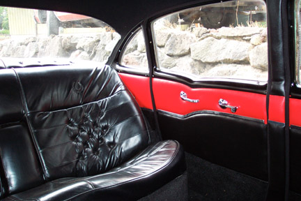

By request (DARK AGE 53) Pictures of my 57.. not an F-body but still a cool chevy. These are before and after interior shots, Im de-chroming and sanding the exterior so I can get it painted so its not much to look at right now, but the inside looks good...take a look see.....
The BEFOREs:
http://imothphfiles.homestead.com/fi...h1-_before.jpg
http://imothphfiles.homestead.com/fi...ar-_before.jpg
The Afters:
http://imothphfiles.homestead.com/fi...nger-after.jpg
http://imothphfiles.homestead.com/files/rear-_after.jpg
I'll get a sound file tonight and post it so stay tunned.

Thanks for posting those pics of your 57, it looks great.

I got the 14 gauge Aluminised steel ones ( same stuff flowmasters are made from) since stainless is harder to weld and I didn't have stainless pipes anyways. The guy is real nice and shipping was well packaged and quick. The mufflers are very good quality- 8 pounds each! and solid. Excelent welds ( I cant do them but I know what they are supposed to look like) might be orbital welds or TIG but whatever, they are done right.
