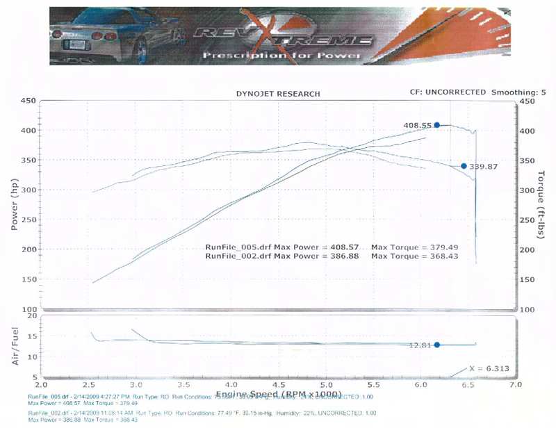

finally bit the bullet on the FAST intake. got it for a good price considering it was already partially ported and came with other stuff.
got in touch with a shop up on the West coast about doing a before/after dyno session to get some definative numbers to compare the setup on a cam only engine.
i'll go through some background on the car
dyno after i had the cam installed, which was a 233/233 .589"/.589 112* Torquer V1.
car had lid, maf ends, ported TB, ls6 intake, Flowtech LTs, orp, 3" dynomouth exhaust....stock clutch and rear end...as well as stock 16" rims (245/50/16s).
car made 382rwhp and aprox 375ftlbs of torque (hard to tell due to clutch slip)
since that dyno i've upgraded the following:
Spec 4 clutch with Fidanza alum flywheel, 3" true duals with magnaflow 4x9 mufflers, harland sharp 1.7 roller rockers, Meziere electric water pump, and swapped over to 17x11 ZR1s with 315 nitto555.
i had the shop run the car on the dyno for a baseline to check the WOT tune and to see the numbers.
the tune was halfway decent, but they only ran the car up to about 6100rpm. the torque had fallen off but the hp was barely climbing. it peaked out at 386rwhp, but we think it would have made 390hp pretty easily had it been reved to peak. mind you this was with the LS6 intake manifold.
after doing the runs, i pulled the manifold off the car and swapped on the ported FAST 90/90 intake manifold.
the car never came off the dyno, and was done on the same day.
first run was way lean, and after tweaking we got results that were quite surprising! not only was the car dead consistent...varying only 1-1.5hp peak, and less than 1ftlb of torque...even after getting heat soaked. but it also showed an impressive gain in across the ENTIRE rpm band.
ended up picking up ~11ftlbs peak, while shifting that peak down about 500rpm. in the low rpm it gained from 5-8ftlbs of torque from about 3000 to just over 4000rpm.
for the Hp curve, it gained aprox 18hp peak....this is assuming it would have made 390rwhp had the baseline pulled higher.
but even going by the peak that the baseline made...at 6100rpm the FAST made +15hp and +12ftlbs of torque over the LS6.
while my cam is relatively large, it not BIG by any means. and the grind is a fairly old design, not even sold any more. bigger cam only cars could see similar if not higher gains, particularly if you rev higher. i was surprised the hp peaked where it did...and am GLAD. really shows where the stock heads start to fall off.
things to consider:
- the intake was initially lightly ported by LPE, but they left some big "steps" just inside the runners. so i cleaned those up and smoothed them out. this was NOT a high dollar custom port job! intake was never separated, and my touch up was done in 2 hrs with a dremel.
- and this is all on STOCK HEADS
I'm not sure about issues with sponsorship, but the shop is extremely good and they were VERY helpful in getting these numbers.
not only did they give me a GREAT price, they were helpful in getting the intake swapped over, and the car tuned and dialed in. the part throttle manners of the car are greatly improved and the peak power numbers speak for themselves.
PM me for the shop name and contact info

Good job
That's not too bad cam/intake only. Much better than before.
Comparatively, I made 414/38* on my cam-only with the bigger F-15 236/239 with an LS6 intake manifold on the Vette (underdrive pulley as well) and now 415/395 with an LS6 intake on the Camaro (no UD pulley and no electric waterpump) with a much smaller 232/234 F-14 HL.
Invest in a better camshaft, and you'll REALLY make some power
I always talk about the FAST 90/90 being worth around 15-20rwhp and torque over the LS6 intake manifold on a heads/cam setup and even 10-15rwhp and torque on a cam setup. Looks like you are another person who found out
Good deal, bro
That's not too bad cam/intake only. Much better than before.Comparatively, I made 414/38* on my cam-only with the bigger F-15 236/239 with an LS6 intake manifold on the Vette (underdrive pulley as well) and now 415/395 with an LS6 intake on the Camaro (no UD pulley and no electric waterpump) with a much smaller 232/234 F-14 HL.
Good deal, bro
