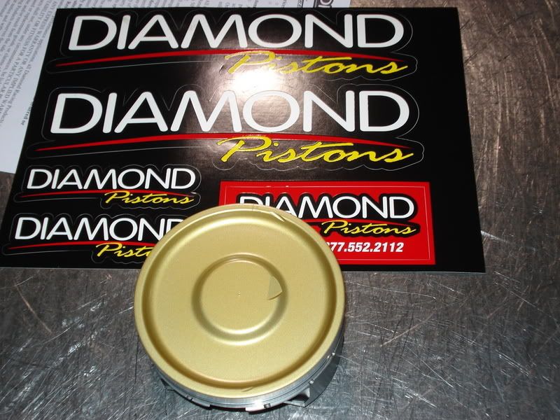

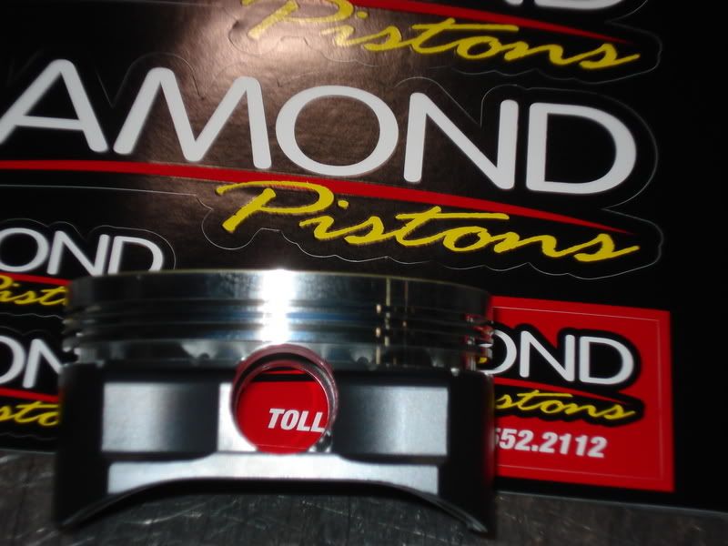

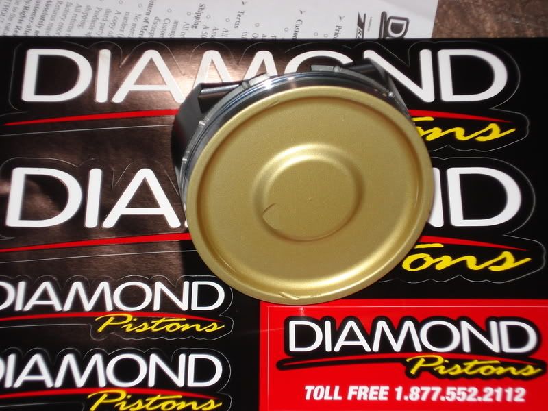

So, the original C.R. for the 408ci was 11.3:1 approx. We needed that to go down to something boost friendly. So, with Diamond being literally around the corner, we had some custom FI pistons designed and fabbed for the build.
Too nice to cover up huh?!

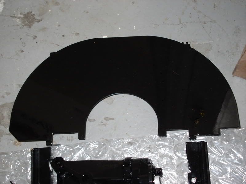

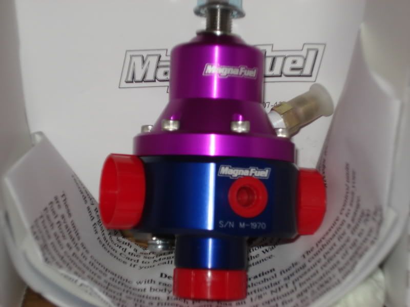

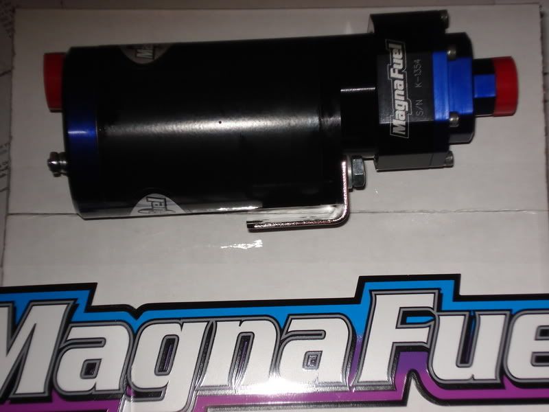

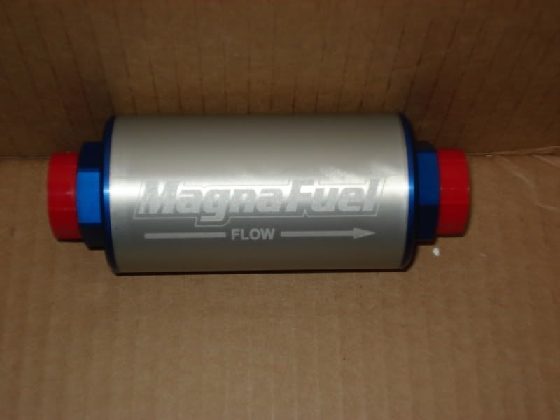

So, with that, here is a short list of the things that have accumilated for the build and some pics of the stuff.
New yank converter for the 4l80e swap
ATI Harmonic Balancer
Battery Relocation:
Flaming River Battery Killswitch:
160lbs Injectors:
Fuel system:
Intake elbow before:
AFTER!!!

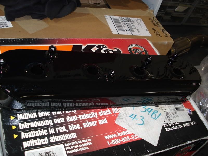

Carb Intake:

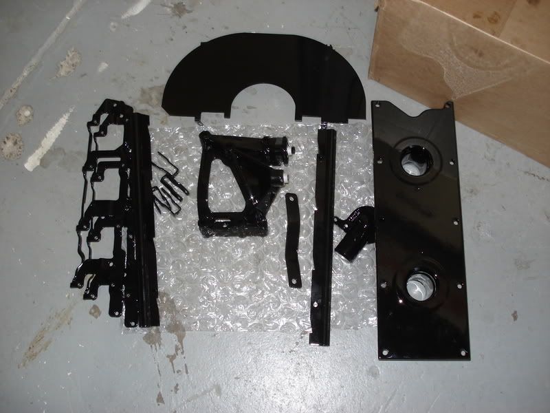

Some parts that Eric had powdercoated:
Moroso Valvecovers:

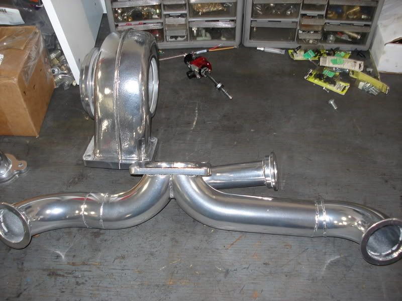

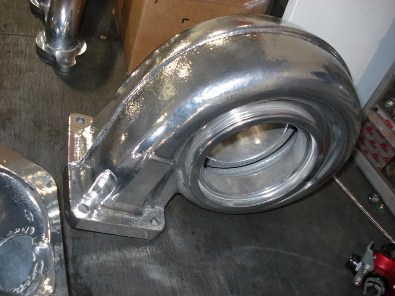

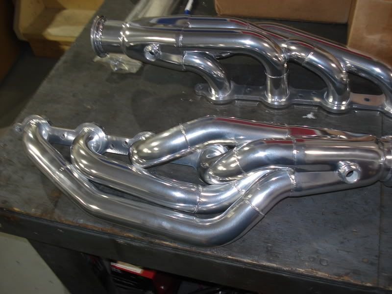

So, we lucked out and found a shop in Ohio that just began build turbo kits for Ls1 camaro's. They are a non-vendor here so it wont be mentioned. The turbo of choice is S85 t6 turbo. Since the new motor will measure 410ci, with the bore needed to fill the new pistons, a regular t4 turbo, even a t88, will be choked to much to produce any kind of useable power. So a t6 turbine housing had to be used inorder to get the job done right.
Here is the turbo and kit. They have been recently powdercoated or jethoat'd, except for the coldside.
