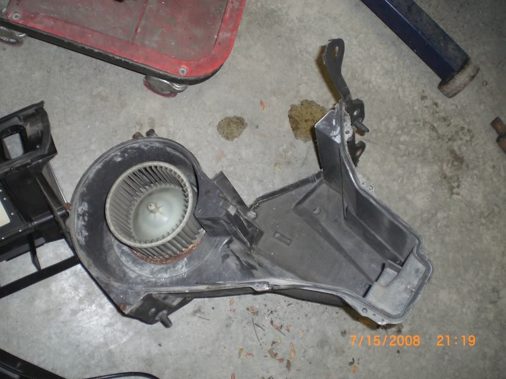

Well... here it is finally with the instrument shell gone. The heater box is also out.
There looks to be extensive modifying of this box. I wish I had a 1LE box in hand to reference. I'll put the box back in the car without the upper portion on to see where I need to trim and go from there. Hopefully, I can still get this done before I leave for Texas.

fill in the gap there in the side area of the box. and that should do you really.
Old Jul 16, 2008 | 04:20 AM
94zgreenmachine's Avatar
Joined: Feb 2004
Posts: 1,309
From: Oshkosh, Wisconsin
Fill in the gap where? The part that leads into the triangular piece? Not so sure. The heater core sits to the right of the fan/cage. I need to look at my GM manual and see if/how the system pulls or blows the air. I am guessing I can narrow it but not close it off completely. I will most likely have a slight pop out in the engine bay but nothing even close to what stock had.
