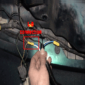

You read correctly. The bulbs are fine. I'm just going to wiretap the driver side to the passenger side. Cheap fix.

You mean the actual control switch on the column? I did wiretap the wires, but the turn signals are really weak but the break lights work now.
