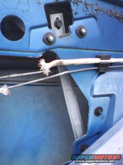

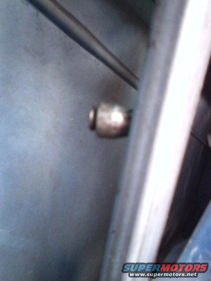

here are some pics...
shot of door where track goes up and down.. nubb piece rides in it...
nubb that is broken off of track
window track where nubb is supposed to be mounted to
so im going to clean it up tonight and try and weld it on there.... if it dont go then gotta call chevy and order a new one..... or goto the junkyard.....
