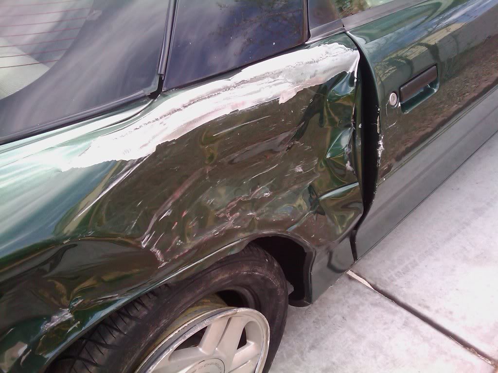

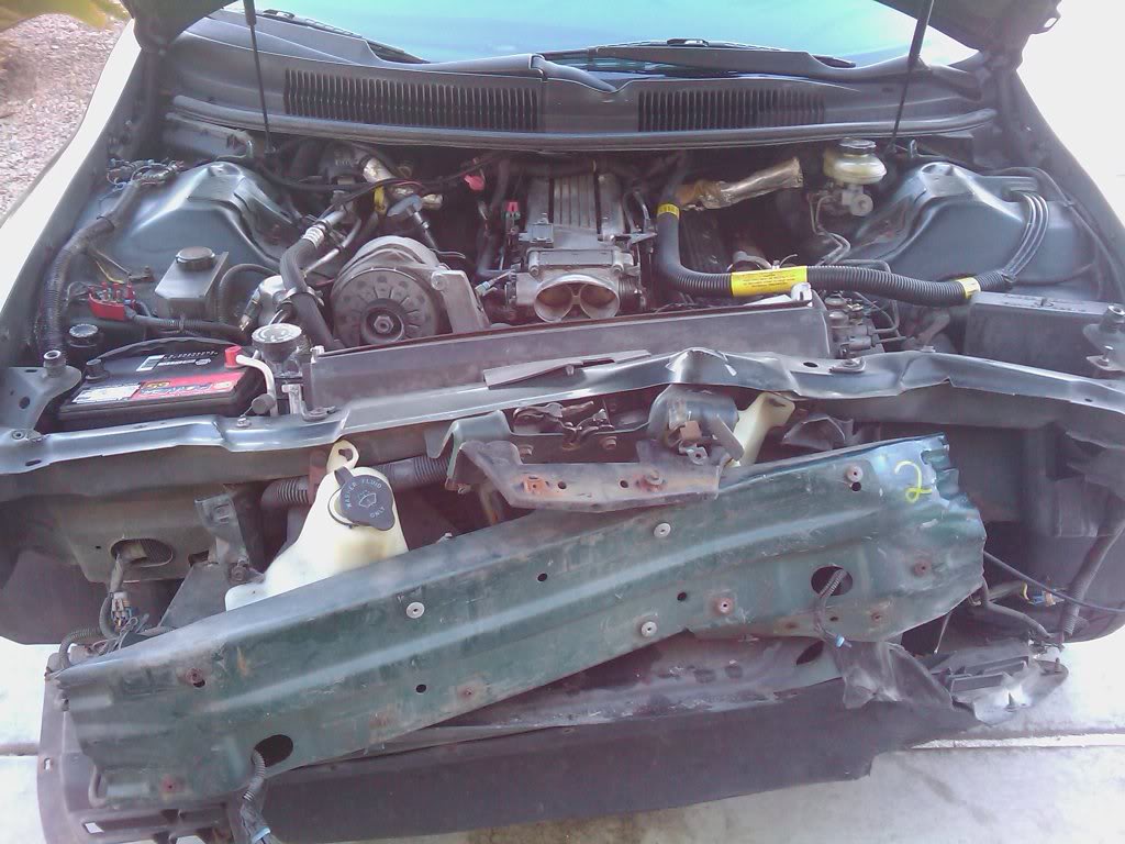

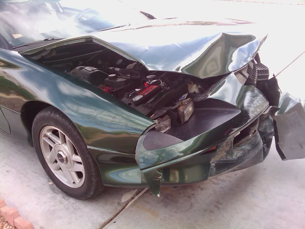

I have a 95 z28 that was involved in an accident. The rear passenger quarter panel was bashed in pretty good and the front end was smashed in a bit. But it still runs and drives straight. How should i go about fixing the quarter panel and the front frame? I only paid $1700 for this car with 153,000 miles. I really love it but if its too much to fix ill just buy another z28.

I did almost the exact same car a few years back, but with far less damage. The quarter takes alot of time to replace properly, and your front frame horns are surely bent, given the state of the front bumper reinforcement. It would cost twice what the car's worth to even put it back to original condition, and then you'd have a 150k mile Z28 that still needs an entire mechanical overhaul. Personally, I like bringing these cars back from the dead, but I have the skill set and background to do it. If you want the satisfaction and learning experience of fixing it, I say go for it. Honestly, though, a job like that is not for a first-timer, and you'll be pouring money into something with absolutely no resale value. Either way, good luck!

thanks for everyones reply, i dont really want to fix it i just want the radiator support pulled out a lil bit so i have at least enuff space to put my intake on properly, right now its rigged up so that i cant close the hood all the way. As for the quarter panel i would like to know if its easier to cut one out from another camaro or to buy a replacement one from GM parts. I dont know how to weld so i would let a body shop weld me on a new one. Ill probably just buy another camaro and keep this one for parts or try to sell it off.

Honestly, if you are asking how to go about fixing this amount of damage, you have no business trying to do it yourself. Given the amount of money a body shop would charge (and age of the car), it would likely be considered a total loss for insurance purposes. There could be a lot of unseen unibody damage.
