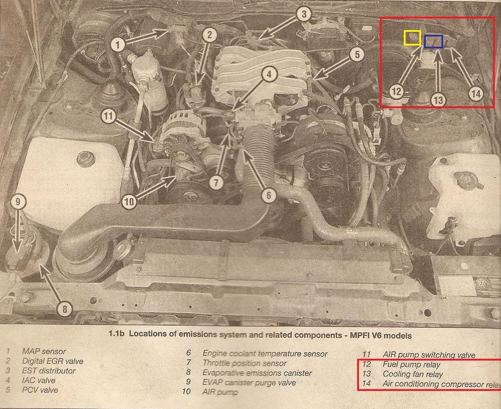

First of all this is as it says a picture of an MPFI V6, but I have a TBI V8. Cant find a picture in the manual of my model. Ok, the red squares are just to show what area Im dealing with here, the blue is where I have something mounted to the bracket that the relays are on, and the yellow is to show that there is no area pointing to this but I do have one there. My first question is, are the arrows pointed to the right places? Because as far as I can see nothing is pointed to the one in the yellow square and arrow 14 is pointed to nothing at all. Also, what is the thing mounted to the front of my bracket for? Its a flat five prong thing that isnt in this picture. My last is, are the relays all the same? Like if I take the harness out of one relay and plug it into another, will it still work? Thanks in advance, this problem is really driving me nuts. Especially the part where I cant even find the third harness(AC compressor).

What is the problem you are having?
IIRC the other thing mounted there is the ignition module, also my car didn't have the A/C relay there either.

A while back I replace the fan relay(or what I thought was the fan relay), but couldn't get the car to crank. The injectors would only drip, and I could get it started and running while someone sprayed gas into the throttle body. I took the fuel line loose and turn the key on and it pumped(no pressure test). Well after I couldn't get it to start I just left the car alone, and a while later someone told me it could be the fuel pump relay. I went back to find out I left the relay bracket and all diconnected. I found out what the two harnesses are that I can see, but I seem to be missing a third harness(AC compressor). My set-up is just like in the picture but with the thing mounted on the bracket. My questions are, is there suppose to be a third harness, and does it matter which of the three relays I plug the harnesses into?
