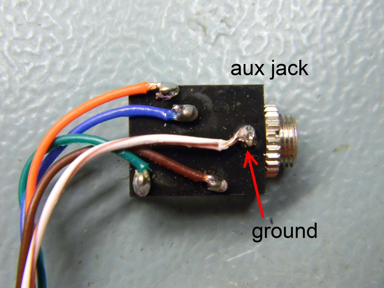

There is no easy way that I know of. The method I used involved opening the radio case, cutting some wires and splicing in some long wires to go to a 2/4-way audio jack on the instrument panel. Most folks put the jack on the front of the radio someplace. I wanted it less conspicuous, and therefore had to use longer wires and outside the radio.

You can't use the disk changer cable for anything else but the changer. It uses a computer-like bus for control. You would have to somehow fool the radio into thinking the changer was playing ok. As it is, the wiring I posted also needs to have a working CD in the player running at the same time. That's so the radio keeps the amps running while "thinking" a CD is playing. It's far from a prefect solution but I know of no other way with this radio.
The steering controls are not affected by the wiring mod. The car has no Bluetooth capability.
What you are looking for is probably a newer head unit. I am just trying to keep mine original and still have some flexibility.
