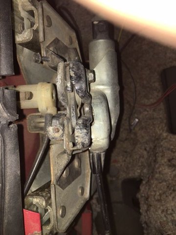

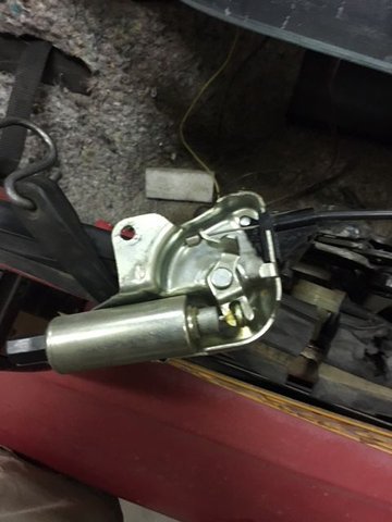

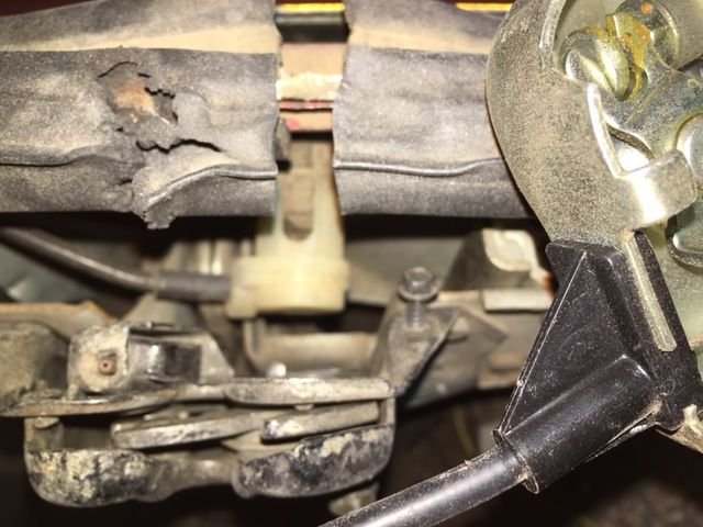

I have photos of the area if you have any questions. Good luck

I took photos of mine. the key cylinder turns a cable which turns the solinoid on the latch. I don't know if your dash switch operates works, if it does have someone push it while you try to open it. I know this is stating the obvious but sometimes you overlook the easy stuff. Now is when it will gets nasty if that does not work. The photos show the parts but everything is behind the plastic panel.If the cable is broken you will have to access the solinoid/latch. It is behind the luggage lamp. It is held on by one 10 mm head bolt. BUT you can not just pop the lamp out to get to it and the lamp is held in really well. Since it is a large plastic panel that covers it and there is carpet over the area .....I ...ME.... I would cut a hole in the panel and repair the panel after the repair and put carpet back over. The panel can not be removed without the back open.. I have not tried to get a cable assembly. Good luck. Is the trunk /spoiler panel moved rearward? If it is I have photos of why it is happening and how to fix it.
