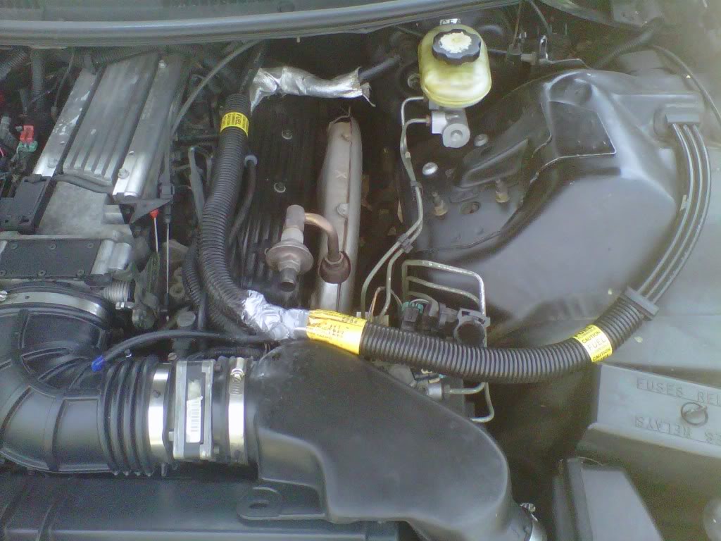

But now I've got a gas leak. It looks like the manifold melted the fuel line where the duct tape is in the picture.
I need help with how long that particular part of the fuel line is so I can replace the hoses.

It goes through the shock tower, behind the wheelhouse liner and down underneath the drivers seat, under the car. There are quick connects there. You can buy the set of fuel lines from the dealer at a reasonable price. They don't really recommend you repair the nylon lines.
GM PART # 10258441 for the line set. Only $28.33 list price.
I notice you don't have the cover over the throttle cable bracket. There is supposed to be a hold down ring (left circle in this pic and seen in this pic) on it that keeps the fuel line bundle from doing what yours did.
Get that leak fixed right away before you have a fire.
You will need a 3/8 and 5/16 fuel line disconnect tool to remove the lines at the intake fuel rail. They are cheap at the parts store.
