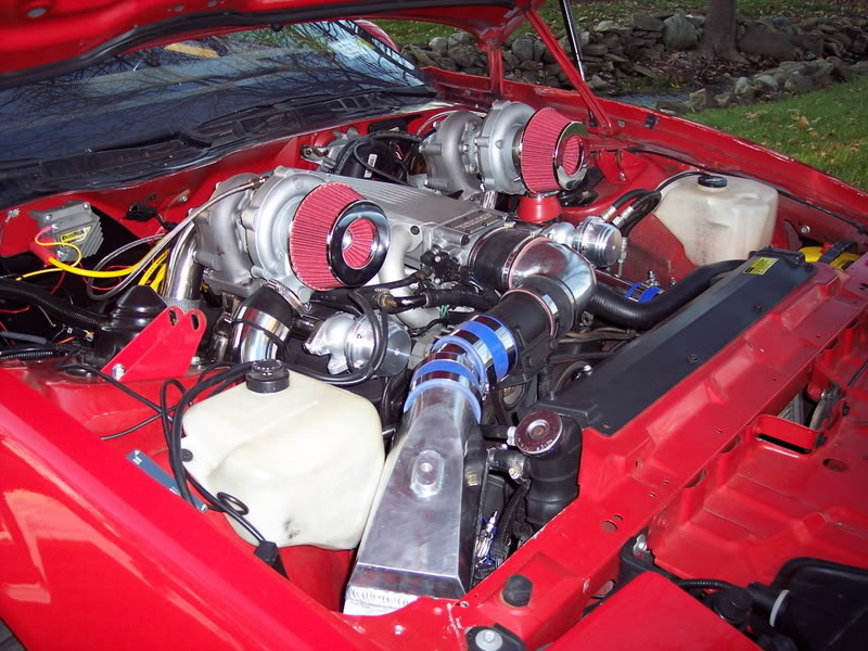

Sweeet LT1 3rd gen turbo setup
...cant wait to see some pics, Im contamplaiting turboing my 383 LT1 87 Iroc. But I need to sell the car. If I dont sell it I will turbo it but well see. Post some pics of ur car and hot parts. I would love to see.

Heres a pic of the hot parts:
Driver side is a 1 5/8" primary tubular header.. passenger side is log manifold. I grabbed this up on another forum for a killer deal. It looks like the area around the turbo flange was re-welded.. it is beefy as hell around there. The biggest issue with these is that they do not have D shaped exhaust ports... so there would be a bit of a restriction using them.

Yeah, thats exactly what it is. I'm like the third owner of it... original owner claims that he had some local guy make him a copy of the BBS stuff in stainless. I don't believe it.. I'm almost positive its SSautochrome stuff.
But it has been re-welded, so maybe its not total crap.

The crossover is a slip fit. I don't care for that at all.. I'll most likely add some v-band flanges there.
It should fit. Thirdgen LT1 conversions just use off the shelf headers for a thirdgen, so I don't see why these wouldn't fit.
And before someone points it out, I know my hot parts will put the turbo right where the alternator on an LT1 f-body goes... I'm running Corvette accessories, so all that stuff is on the drivers side. I have plenty of room to work with on the passenger side.
